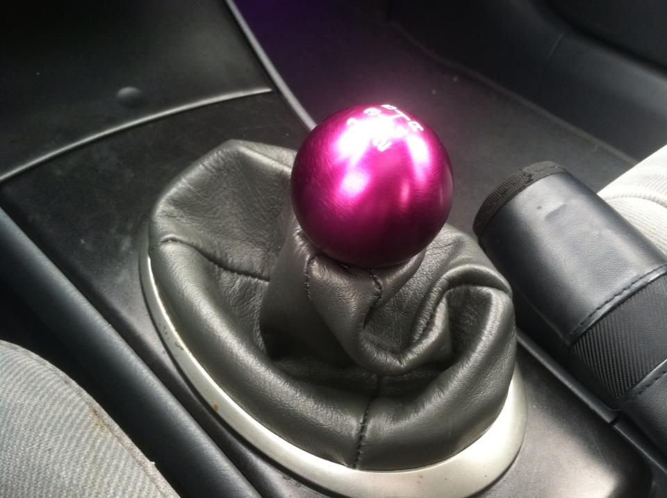

I ran into a bit of difficulty keeping the boot from sagging, but I placed the car in 5th gear (which I determined to be the longest throw), keeping the **** attached, I removed the shift-boot housing and lifted it so I could see the underside of the boot. I then used the included zip-tie to hold the boot in place while I duct-taped it to the shifter. Perhaps not the most tactful way to secure it, but It certainly does the job of holding it firmly in place, not that the improv-engineering shows anyhow.
This is how it all looks:
I hope someone finds this post to be helpful!

I do like my REVO!
Looks really good! Can't even tell duct tape was used.
