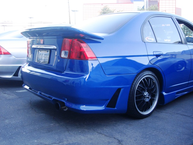

dude i totally agree with you! and those thats having a hard time taking care of it just drive carefully and know your roads. but uhh heres mine guys its a VIS fiberglass Brand and they come predrilled at the area for the trunk bolts. any questions on how i did it just ask.looks better when maximized
