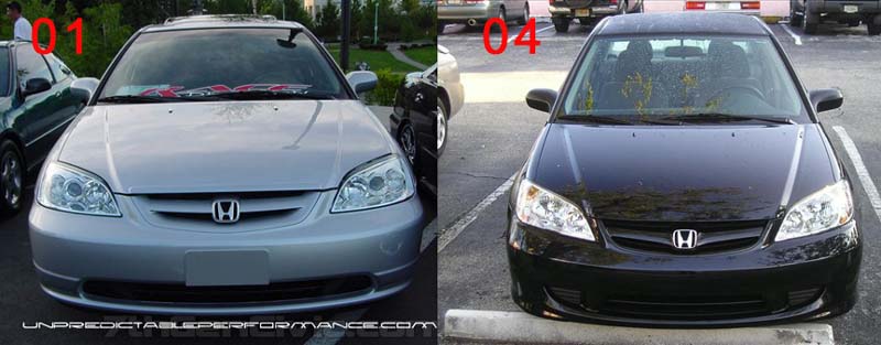

good luck installing, but by looking @ pics I REALLY dont think it will work.
The 01-03 grill is much more angled, where the 04 is a smooth curve for the most part.

it won't work...for sure
I tried JDM Ferio Grill on USDM sedan and I already had hard time! because JDM is 1cm smaller at some places.
so you will have extremely hard time to fit 01-03 grill to 04
