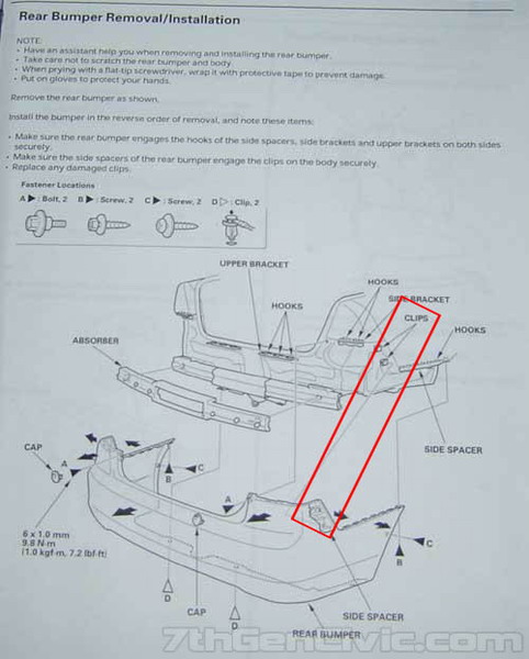

Just take the bumper off, its easy man dont be lazy. Belive me i tried to do it that way, and it just made it harder for me. U gotta remove the bumper, theres 2 screws under the rear wheel well on both sides, then u take the 2 bolts covered with a small black oval shaped cover off with a 10mm i think. after that theres 2 more screw/caps under the rear bumper u take those out with a flathead, the yank and pull method works, but start from one side, and have someone hold it while u do the other side or itll fall off.and its not heavy at all.
after that u take screw off the rack thing, and u can take off the tail.

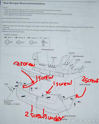

ok i'll get one of my friends to help me over the weekend.. is there enough clearance in the wheelwell to fit a screwdriver or do i have to remove the wheel? what about these clips that i highlighted?
i'll keep you guys updated.

There's enough clearance. Once all the bolts and screws are off, just yank from the corner and it'll pop off.

Yeah you need to pull/push those parts that are held on by clips. Then once it's secure, start putting bolts and screws back on.
