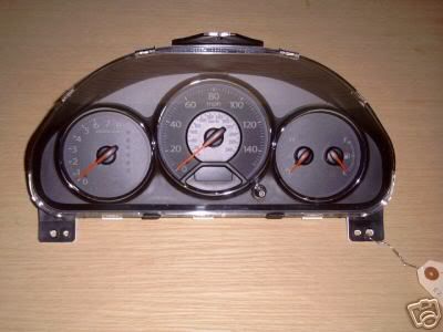

Thanks for the help, This is the 03/04 EM (sedan is EM right?) cluster, but auto right?
do they make the sedan (blue) EM cluster in manual? just hard to come by right?
that cluster looks to me EXACTLY like the shape of my EP cluster, some holes for mounting etc... of course it's hard to tell from a picture, but the shape is much more similar to the Si cluster than the RSX cluster to my knowledge. And I've taken my EP cluster apart ALOT
Old Jan 17, 2005
Rep Power: 812
Yup my spare is exactly like that. Got it from ebay for $110 shipped. Keep checking, they always pop up from the junkyard sellers in good shape.
