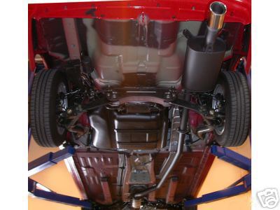

Hold on dude I have a pic to help you...
Old Jan 8, 2004
IronFist's Avatar
Posts: 22,702
Rep Power: 529
Ok. Here is a bottom view of the RSR EX Mag catback exhaust on our car. It's supposedly one of the best exhausts out there for us, so if you get custom piping, tell them to copy this design.

whats the size of the tip and piping on the rsr ex mag? i've been lookin for a good catback, and now im considering this one. how does it sound? is it loud? deep or ricey?
