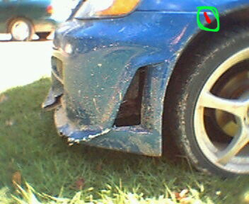

I happen to have this same bumper, also in the same color ironicly... so I just took this picture and put a red mark about where the total break and seperation is, then drew a green circle around it... you cant miss it

Old Dec 25, 2003

DUCT TAPE! heh... yeah try and fix it with some bondo and fiber glass resin
Yeah, I think your best bet is to take the bumper off and do the fiberglass on the bottom side. I will take pix tomorrow of my fiberglass patch up job and try to post them.
