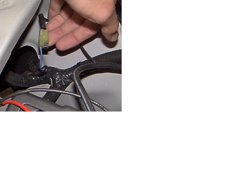

well i e-mail the member whose photo that is and he told me where to get the light and that everything will work. you just have to wire it to the blue tach/testwire by the headlight. does anyone have a diagram or picture of where this wire is that i will have to tap into? thanks.

wait just a sec and I will go and take a pic

here you go, hope that it helps

thanks man. is there any writing on the wire to help identify it or anything? or is just the only light blue one in there?

its the only blue one with a plastic clip on it

so did you have to cut open that loom or was it sticking out like you have it now?

it should be just like that, as far as the other wires, you can get a hot lead from your instrument cluster( with a test light, KEY on... lights off)
and just ground to any steel member or to the instrument cluster ground (see wiring diagram in the DIY section )
