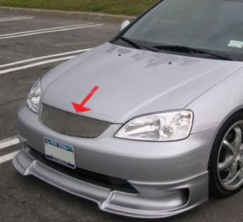

i seacrhed and checked grillcraft.com install info but it didnt asnwer my question. i'm ordering a grillcraft grill in a short while so i decided to take off my bumper and take apart the grill to see where it goes and i got a little confused. does the GrillCraft grill go inside the grill that has the H symbol on it or does it get put in or glued in between the bumper and then attached to that black thing made of thin plastic that holds the bumper between the headlights to the car under the hood?

I'm not sure what you're asking but the Grill Craft upper grill replaces the entire existing grill on your car.
Here's a pic of the grill craft
Name:	grill craft.jpg

LOL can't get any simpler than that picture.
Take the bumper off. Take the oem grill off. Secure the Grillcraft grill onto the bumper where the OEM grill used to be. Put bumper back on. The End.
The Lower Grillcraft DIY instructions are in our DIY section. It is also in the grillcraft website: http://www.grillcraft.com/installs/i...iew&install=50
For Coupe, you have to take out the whole OEM grill, including the black radiator cover. For sedans you can keep the black radiator cover there. I think MAYBE you can reuse the Coupe radiator cover. The front H part may get in the way though, as you said.

1 more question, does the upper grill fomr grillcraft come with all the needed supplies to install it. and is the grill glued into place ot bolted into place?

It should come with instructions on how to bolt it in. If it doesn't come with screws, then the grill probably uses the oem screws.
good luck with the project. 75shot installed a grillcraft upper grill and it looks pretty good on his black 7th gen. If you need more details, you should pm him.

it comes with all the hardware, three screws to be exact. It is a simple install and you will LOVE it, you can't beat the quality. Check out my ride for a pic.
