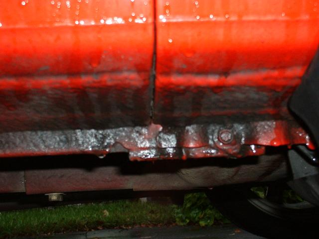

hey guys I just really want to know where the appropriate jack point is for the front of the car is also.
Here is a pic just took of my passanger side under the car right behind the front wheel (you can see the splash gaurd).

if you can just please tell me the best you can. And I'm sure Yukon's explanation was perfect, but it's pretty confusing to the average driver.
Please take my pic and draw on it and upload it a pic that tells us where the jack should be touching. I don't want my hood to become "hella gapped when I close it". I want to see if i've been doing it in the right place.
holy crap my underbody is dirty. I better clean that up before the snow comes.

THANKS CARBON ROD!!!
Now I can rest assured that I have been lifting the front of my car in the correct place. I was affraid that that square thing might have been what Yukon was talking about, the radiator support.
