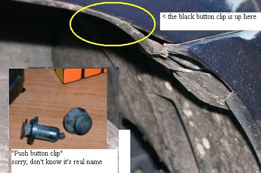

That's why i'm keeping my ride on stock suspension. Even with stock wheels, I scrape on the top of the wheel wells just like that on my way to school. I have 18s on with 225/40s (slightly larger than recommended; but it reduces bumps) and I have to slow down when I'm approaching that dip in the highway.
I saw one day that the black plastic clip/pushbutton thing above that screw area was rubbed to death. The top of it wasn't even there anymore, so I couldn't pull it out. I had to jam it in and then I peeled the wheel well to get it from the inside the bumper where it dropped.

better idea of what' i'm talking about:

those are bumper clips.. they are kinda expensive from the dealer...

everything's expensive from the dealers. I went to a junkyard that said they had a 7th gen, expecting that it had a lot of good parts. But when I got there it was stripped to the frame, and have to have been sitting out in the lot for a year. All I left with were a ton of screws, and those bumper clips. Figure I'd keep them for spares because when I tried taking one off during spring, the tab broke off. I had to push that one through the wheel well as well.

try like 4 dollars a piece, had to buy some
