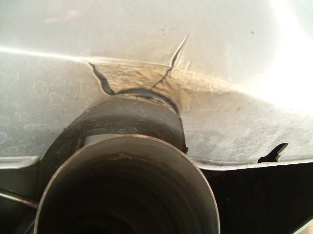

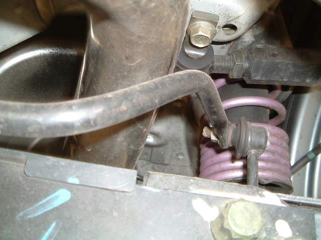

I saw this on ebay and i think it'll fit nice cuz the TCS exhaust that ive got now is really burning the heck outta my bumper!! . I cant just lower the hangers cuz the piping on the muffler will hit the sway bar . Greddy exhaust

ouch!!! Looks like old wringly skin!!

The sway bar touchin the piping of the TCS.

Isn't that just your stock bumper it's melting???

i have the tcs exhaust and have never had that problem. mine burnt for a bout a week and was very minimal, it is now fine.

I also have that exhaust and have never expierinced burning...Hmmmm. The TCS sounds good, but if you want something else, go with the apexi WS...It's cheaper and it sounds awesome

just take the sway bar off.. and lower the hangers... i have a sedan.. with the tcs... not one problem... then again.. i dont have a rear sway bar... i really see no need for one... i have upper rear strut bar and lower tie bar...no swaying here.. nor bumper melting..

No rear Sway bar = understeer like no other.....
Strut bars and tie bars do entirely different jobs then a Sway bar.
So, Dont take it off.

Read and understood buddy. I should have stated it more clearly anyways, so i guess it's my fault. What I meant was that I'm suprised that DC, a very reputable company, would make a full catback that would still burn the stock bumper. Spending $600 on a catback isn't cheap, and they didn't even have enough testing to make sure it didn't ruin the oem parts.
I looked in your member's ride and saw that you do have some aero parts on your car, such as the front and side skirts. Just didn't see a good picture of your rear bumper, so don't really know if you added any thing to it. But from the picture, it appeared stock and it just suprised me that DC would allow something so obvious to happen. I think you could complain to DC about this and get something out of it some chance.

Really? Hmm....... Then I guess that Large ammount of Understeer that I got rid of when I Upgraded to the RSX's 19mm rear bar was all in my head.
Dude, If you think that Having or not having a rear anit-roll bar on our cars makes no difference in handling then you've never felt the difference between haveing one and not having one. Read up on suspension therory and you'll under stand that the Anti-roll bars primary job (IN a performance aspect) is not to reduce body roll, but to adjust the roll resistance on one end of the car or the other. This in turn controls where weight is transfered to durring a turn wich in turn determins If and when the car will understeer or oversteer in a corner.
