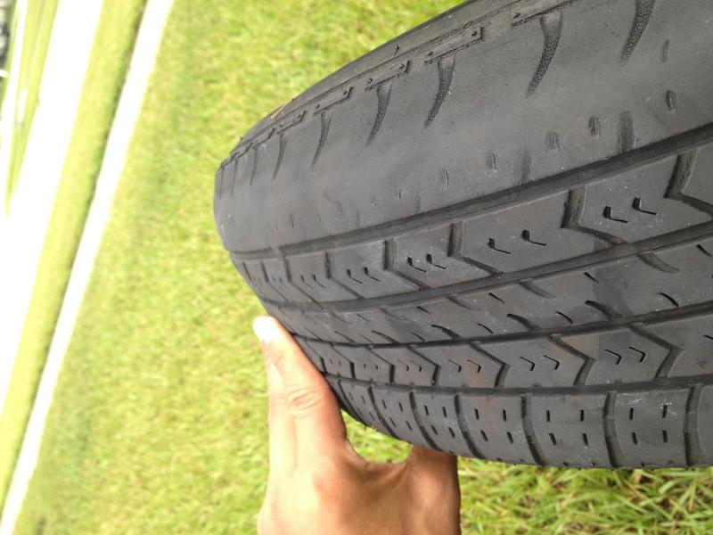

So I have a 2001 Honda Civic LX with 220XXX miles. I've had it for 4 years and I only had minor problems here and there. However, in the last several months I have had to get 5 used tires. All of a sudden the car is exploding tires out of nowhere. It's usually the passenger side tires too.
Yesterday the car randomly began to hop so I drove the car straight home and took the tire off before it could flatten. Upon doing this I noticed that the car hopped because of a hump that had formed on it.
Is there any particular reason why this is happening? Do any of you know a solution?
The pictures below show the hump.

Have you ever gotten an alignment? From how the tires are wearing it doesn't look like it.

Yes, not too many times. Do you think i'll have to get four new tires before I get an alignment.

Get 4 new tires, an alignment, and have whoever does the alignment check your suspension components for wear.
Edit: you could get away with just front tires but you should get your alignment checked. Tire pressures can cause uneven wear also.

Take a picture of inside and outside of rim,
My best guess is a bent/damaged rim.

^ +1 on the wheel potential issue. could be other suspension problems, thoughm, but wheel is more likely
