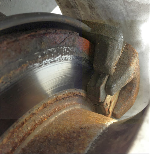

OK Folks, where did I screw up?
You can follow the history of my saga above. In short, my first Honda brake job. Didn't realize the pads had "polarity" (studs). Through the brain trust of this forum, I was set straight. I rechecked the pads and I discovered I got one right, one wrong, I corrected the wrong one after 50 miles.
Because the rotors had plenty of meat left on them, I didn't turn or replace them. I gave them a cursory sanding with an orbital sander, and re-installed them.
After 100 or so miles, I noticed the pads were not making full contact with the rotors. Certainly not like the OEM ones. I let them go another few thousand miles to see if they would eventually bed in and make full contact. Well, here it is 18 months and many K miles later, and they still don't make full contact.
See pix here:
https://picasaweb.google.com/pjw73nh...eat=directlink
Recently, I parked next to a similar year/model and had a look at THEIR pads/rotors. Full contact.
So where did I mess up? Wrong pads for the car? (Physically, they matched up pretty good to the old ones). Wrong application of the pads? (Materials) Not turning/replacing the rotors ?
The brakes are working great, no errant vibrations, noises drag, etc. E-brake works fine. Even if I apply it while driving it does an excellent job of stopping and holding the car.
Any thoughts welcome.
Thanks.

Old Jan 8, 2014
CraigW's Avatar
Joined: Mar 2005
Posts: 4,904
Likes: 14
Rep Power: 308
CraigW is a glorious beacon of lightCraigW is a glorious beacon of lightCraigW is a glorious beacon of lightCraigW is a glorious beacon of lightCraigW is a glorious beacon of lightCraigW is a glorious beacon of lightCraigW is a glorious beacon of light
Re: Brake noise? Backing up.
Certainly something going wrong.
Just don't understand people and 3rd party parts.... you cannot win.
Old Jan 8, 2014
I see the pic now, thanks Craig.
Erm, slap on a set of good quality(?) rotors. I'd say pads too, just to be safe.
Once they have rusted like that, they don't seem to stop. You'd have to make a deep cut on a lathe to reach 100% fresh metal, and that would probably put it below minimum thickness spec..
EDIT: Also peel the clips off and clean out the rust in the bracket so the pads are free to move. They should not be in a bind.
Old Oct 28, 2014
rgar98's Avatar
Joined: Nov 2009
Posts: 9
rgar98 is an unknown quantity at this point
The slot in the piston must fit over that pin. If it doesn't, then the piston pushes on that pin and the pad will wear really crooked, and can cause odd wear on the rotor.
This is exactly what happened to me. The pad does not contact the rotor on the outer edge.... finally figured it out.
