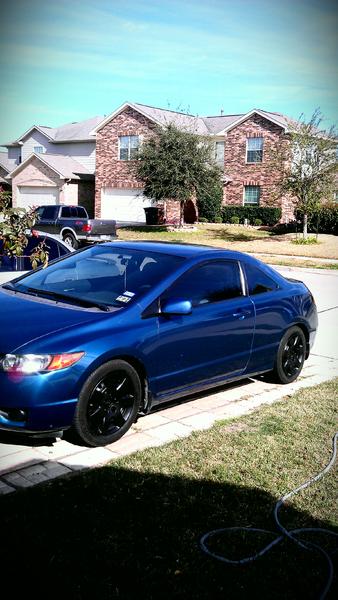

I have stock hubcaps on my car since I just bought it but looking to by rims. Should I get 19's or 18's?

Whatever you can afford.
195-65-15 was a stock size
205-55-16 was a stock size
215-45-17 was a stock size
See what size 18s or 19s will be the same overall diameter as your current tires.
http://www.miata.net/garage/tirecalc.html
Then figure out if the size is even available and for how much $$$.
http://www.tirerack.com/index_w.jsp

Yes 19" rims will fit..BUTTTT! The cost of a 19" rim and 4 tires is kinda high verses going to the 18" wheels and tires.
If your going to do the 19"s they would be 225/35/19 , if you do the 18's the tires would be 225/40/18's..Price the 2 different packages and you will see the price differences..
Great choices out there..Look wisely
