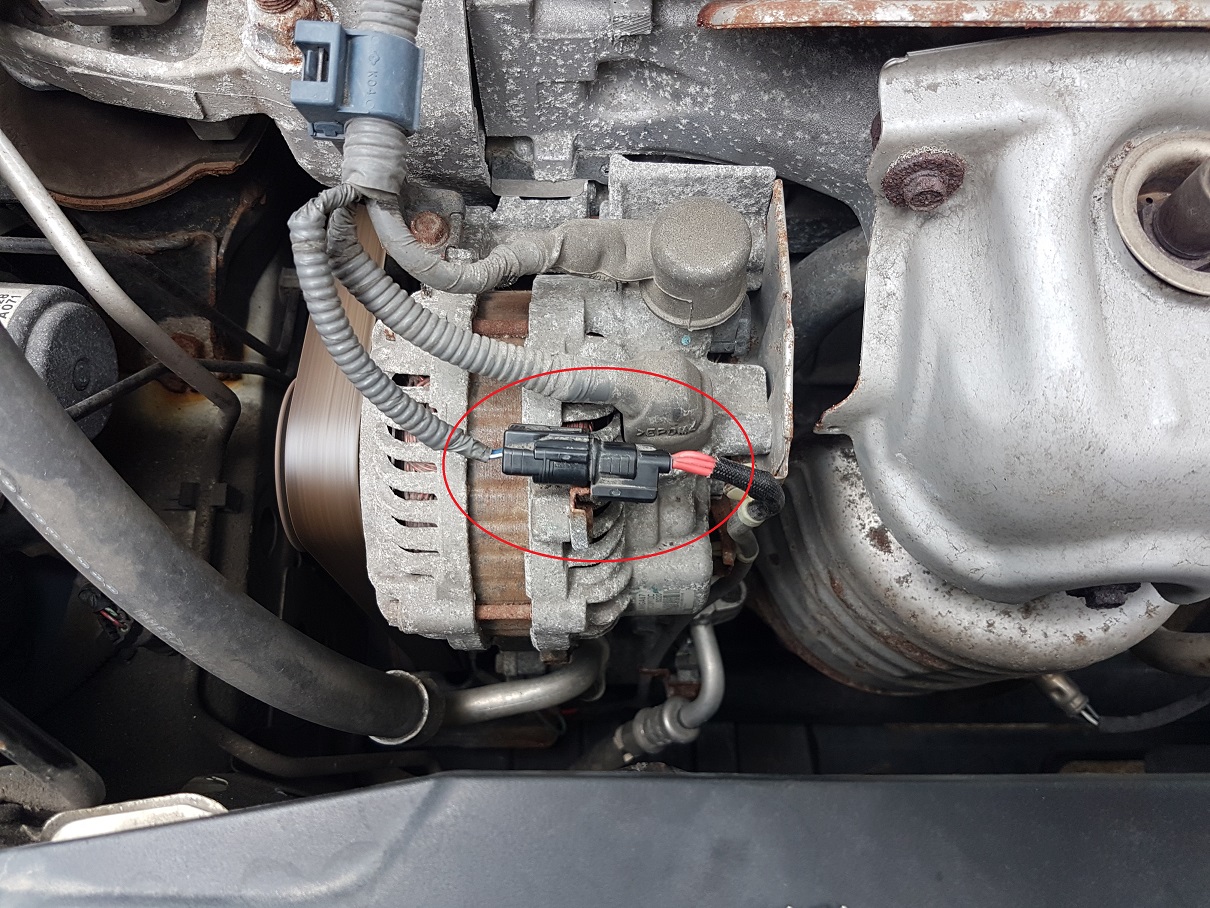

After poking around a bit I noticed a connector on top of the alternator was unplugged. It's 3-wire and the wire runs down to the compressor.
I plugged that in, and now I was seeing 14V at the fan connector. Plugged the fan back in, and it started spinning. Still no compressor spinning though.
Then I noticed that the fan kept running even once the A/C switch on the dash was turned off, it just always runs when that connector is hooked up. I'm guessing the previous owner disconnected this wire because the fan was running constantly. In poking around, I've noticed if I wiggle that connector or the wires on either side of it at all, the fan shuts off. I can hear the relay click when this happens as well. It seems Like there may be some short in it. Wiggle it a bit more and it comes back on again. Photo of the connector attached.
I plugged that in,
Test (backprobe) the center wire, see if it has 12v+. Center wire runs the clutch field coil.
