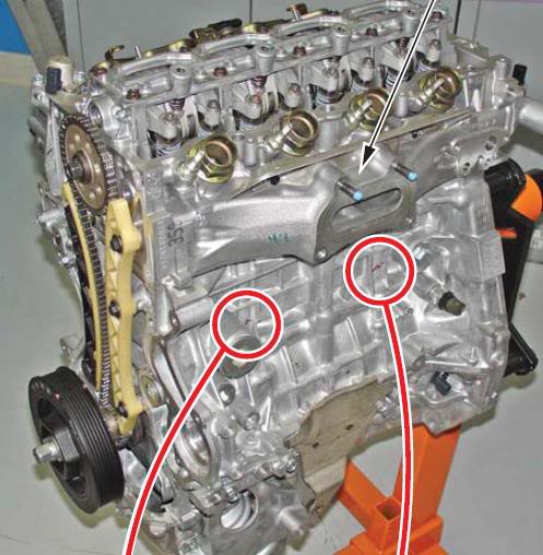

Above your left knee, find the 2 buttons...Push select/reset to bring back the odometer and tripmeters.
I did have to fill it for her 2-3wks prior to this issue, and it took a full gallon.
Could have taken more,
Full gallon of coolant? This sounds like it could be a bad situation now.
Where is it leaking?
How hot has it been? Is the orange oil dipstick melted or charred...about 4 inches down from the ****?
In fact, stop right there and find out where the coolant went ASAP:
Time is of the essence, no fooling around now

Re: What does this sound like to you?
See pics above. Look for leak evidence (stains) on your engine as indicated in the pics

I watched a youtube vid on it and see that I can spot the areas on the front from above.
Old Jan 18, 2017
If leaking on the front side in either location, that should be real easy to see with the hood up.
ON the back/underneath, a leak could come from the starter area (hidden by the starter), and the 4th place would be inside the black cover and would slowly fill the oil with antifreeze if leaking there.

Just started looking at it. Both areas on the front of the block are clean. Checked the coolant and it is still full, although it's only really been ran for maybe an hour since last filled. Oil is not over full, and looks good on the dipstick, but I opened the cap, and it does look a little milky, hard to tell if its from a small amount of coolant, or just from the oil to me.
