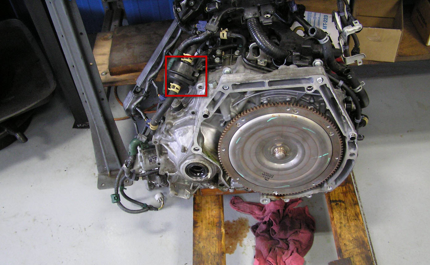

Here's a pic of the trans out of the car. You can see the filter at about 11 oclock from the bellhousing?

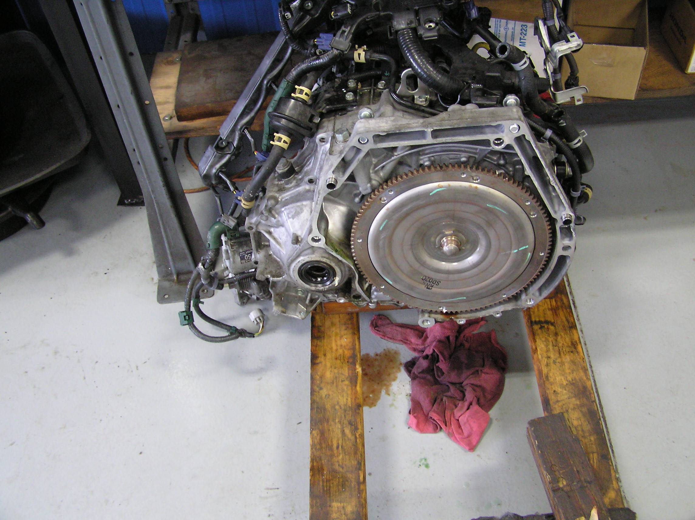

One I have highlighted from your pic is the filter?

I think, that's the part: 25430-PLR-003

Yes, that is it.
01-05 have no external filter.

I forgot to note, the trans in the pic is 8th gen (06-11) , your 9th gen is about the same
