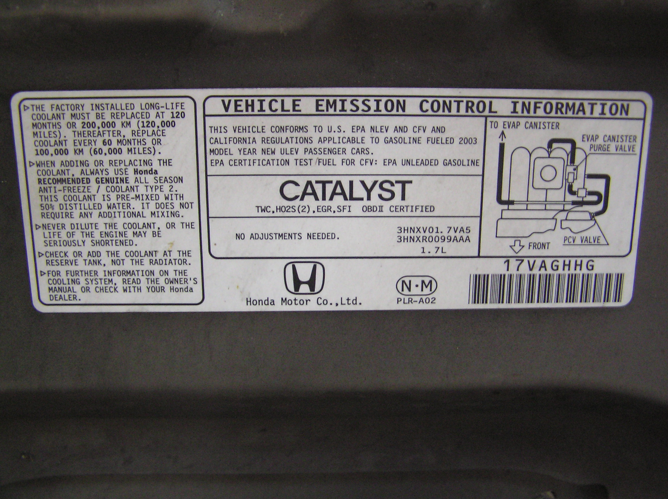

Your factory coolant doesn't need serviced until 10 years or 100,000 or 120,000 miles or item #5 pops up in your maintenance minder display.
Open your hood and locate this sticker and check what yours says:
(This one is from a 2003)

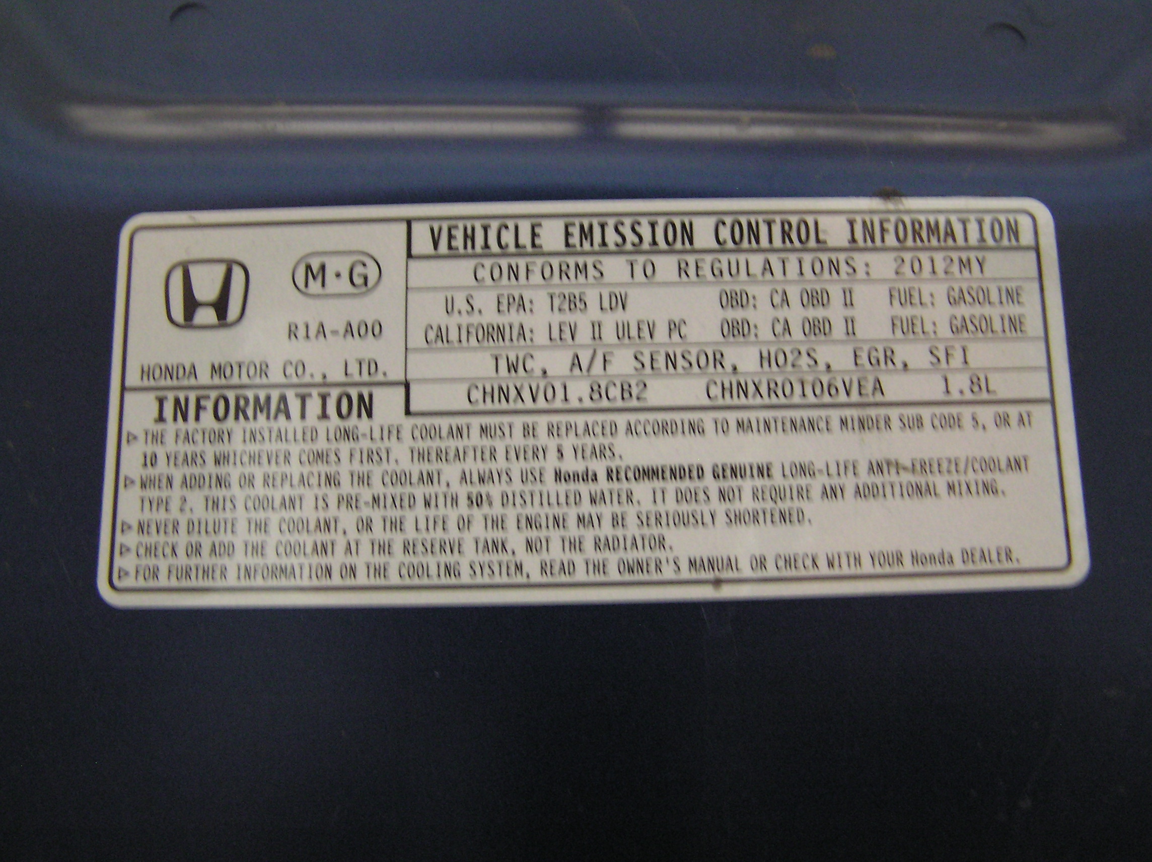

2012 sticker pic
