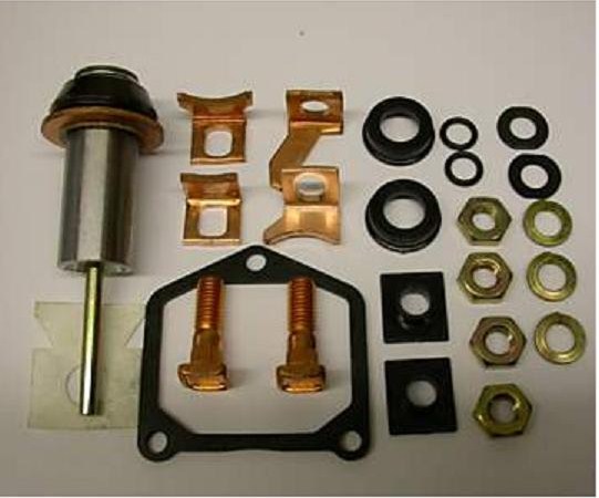

Signed on to see myself. Think it's in the starter (other then the small relay on the fuse box that the key switch drives and then that turns on the starter relay. Use to be you could get a kit to replace plunger with contact and the contacts. They are only about $15 for a Toyota.... Could be the key switch going, the small relay or the battery going. Start at the battery and the connections. Simpy first. How many miles do you have on it?
Name:	6 Starter solenoid.jpg

Ezone is truely the expert here. You can actually get the starter relay in the starter that includes similar parts in my picture. It's only 8-10$. However, that kind of work is limited to the backyard mechanic if you have the skills.
