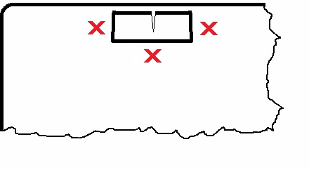

Regardless of where you order it, you'll be looking at a range of $45-55 for a replacement, even on ebay. My gf's 08 had the same problem, so I tried a few fixes, and settled on a similar fix to the one you mentioned. The only difference is I used 3 bolts (instead of Sweeny's 2), and it seems to be holding up nicely.
Approximate location of where I put the bolts
