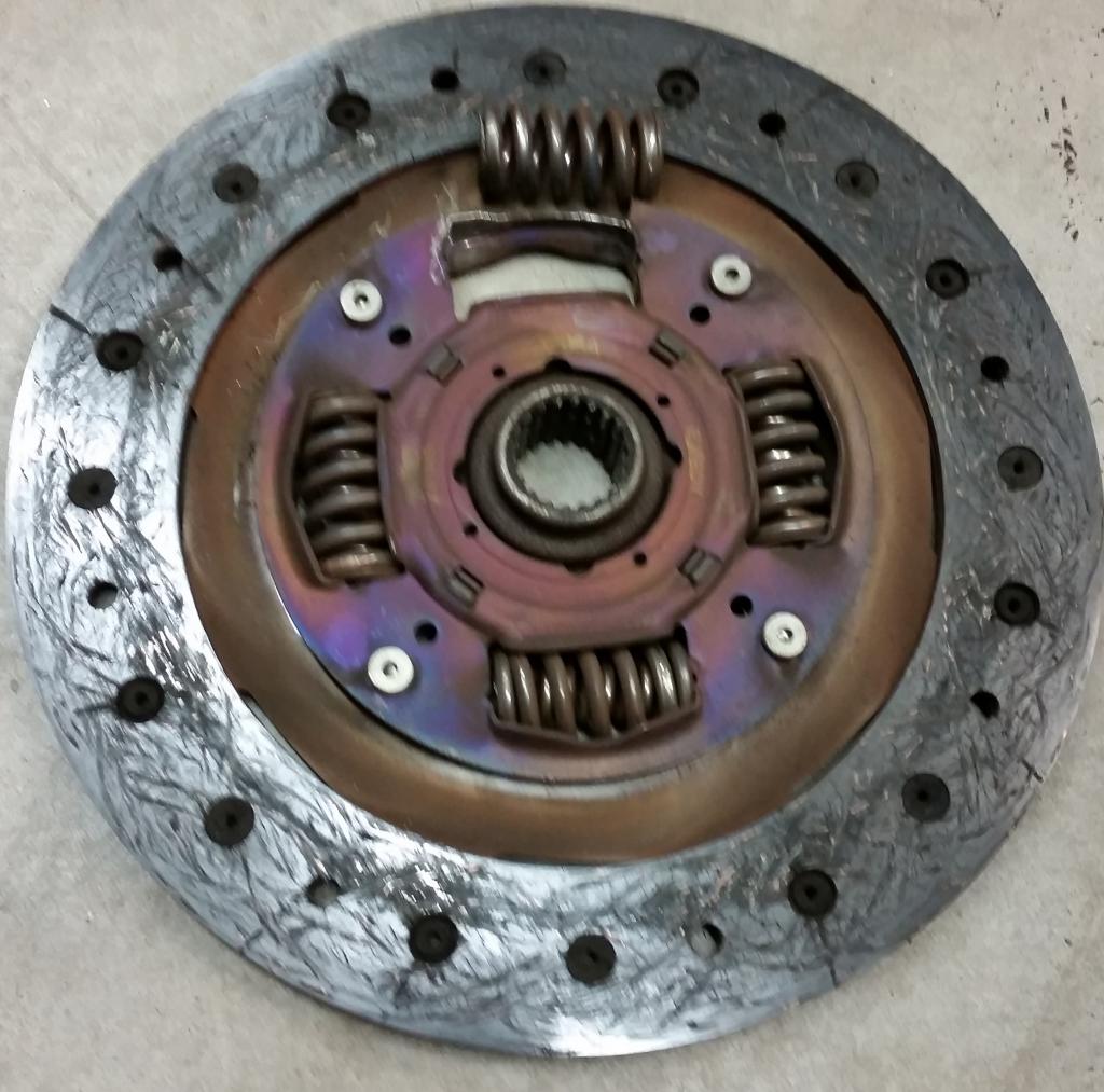

[SOLVED] Bottom line, there was a spring that popped out, so the clutch had to be replaced. Read the whole post, but the synopses is here. https://www.civicforums.com/forums/1...ork-moves.html

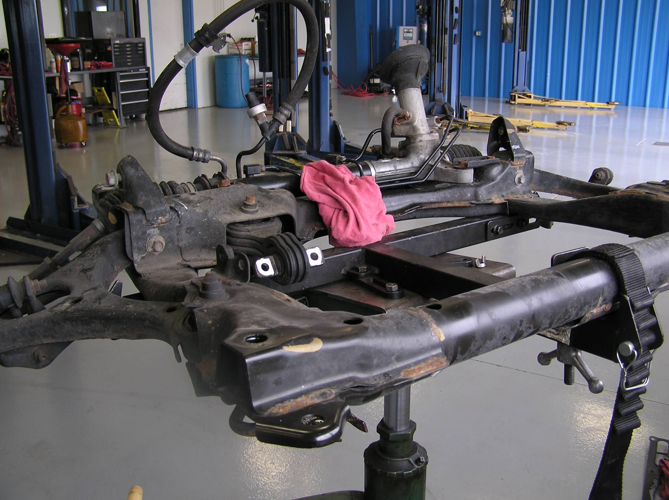

Subframe pic, 8th gen

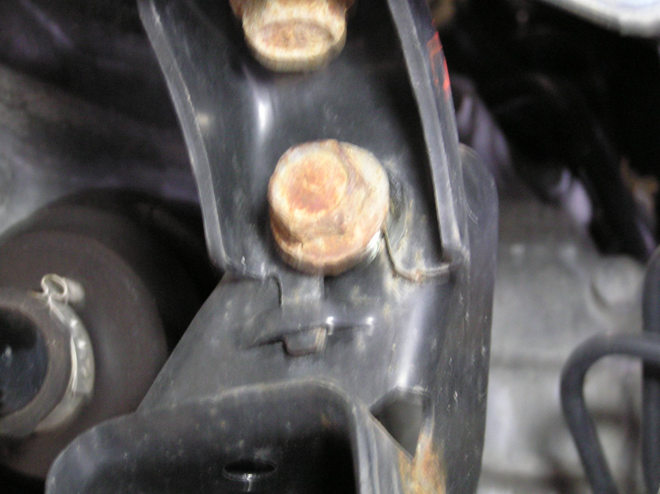

How to keep the subframe aligned---take it apart the right way and it should go right back together into the exact same spot.
Engine and trans will hang by the top 2 mounts while you remove the subframe.
Lower ball joints are great too, each one is attached to the lower control arm with 2 bolts and a nut. Gravy!
EDIT: Or 2 nuts and a bolt. Whatever.

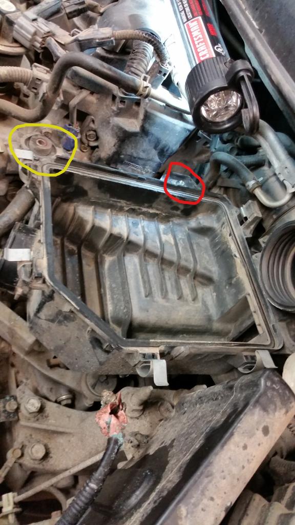

I trailer the car to my house last night (about 60 miles). Glad we did, there looks to be ice on the roads this morning. I am assuming the K is a vin destinations. I told her to write down the vin when she ordered the parts. I forgot to have her get the trans fluid, so I have at least on trip to the parts store. Now that I have to car I can verify the model. I am assuming there is a sticker that has the engine size and such.

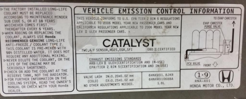

The engine letter is not in the VIN, it's stamped on the block.
An 06 Civic will have a 1.8 engine, (engine type "R" as stamped on the block, i.e. R18A1) unless it is an Si, which has a 2.0 "K" type engine, same engine family as the engine used in Accord, CRV, Element, and others.
http://en.wikipedia.org/wiki/Honda_R_engine
http://en.wikipedia.org/wiki/Honda_K_engine
Hear me now, believe me later: Get the correct fluids from a Honda dealership.
I know, nobody is open on New Years day. I wouldn't trust most aftermarket fluids nor would I trust the idiots at the parts stores that tell you the fluid works on all cars.
It's amazing how much stuff can go wrong when the wrong fluids are dumped in. Power steering is a good example.
There should be an emissions sticker with the info. You may have to decipher it though.
Check the pictures in the wiki links above too.

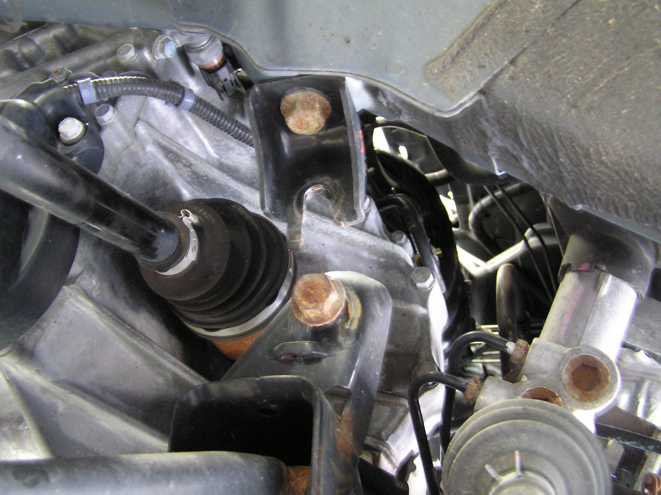

That confused me, it did not look like they had to do that. Also showing the subframe bolts, then it does not look like they dropped it. In fact at one point after the trans is separated he says you can lower it on the subframe. [went back and listen again, he says all but these bolts] Anyway, I knew I was going to have to feel my way through this, I think between you, videos, and the DYI I have some idea of where I am going. Now to light the heater and get started. :-) Thanks all and happy New Year.
The service info I checked earlier has the subframe being removed to get the trans out of the car.
I don't know if you can get around that.... If you see a way to do it that way, go for it and report if it worked or not!
I managed to do it once on an 01-05 Civic (a completely different car) without dropping the subframe -- just slid the trans back far enough to do work, but IDK if others would.

Trying to remove the lower air box. The bolt that hold the front was missing. I have the both hose clamps (big and little) off. How does the rear remove? It looks like a pin.

BTW, I will respond to ezone latter, here is the emission tag. Looks like an R.

First pic, rubber donut stuffed over a steel pin. I sometimes spray some carb cleaner on the rubber to lube it, then pry upward to release.
2nd pic says 1.8L, so that's the R engine.
Did do it without pulling the subframe. I have some details for future searchers, but for now need to finish putting the car back.
Question, were do we put the oil back in?

Originally Posted by ezone
Fill plug is a 17mm hex next to the differential.
On top below a bracket?
On the side, through fender well?
How do you know when full?
What the torque on axles nuts?
Is there a trick to get the driver side drive shaft in?

Rep Power: 518
Re: 06 Clutch will not disengage (Master/Slave does not appear to leak and fork moves
Fill plug should be very similar to this as seen through the drivers wheelwell or from underneath. This pic is labeled as an Accord though.
Set car level, Fill until it runs out the hole.
Do not remove any other bolts or you can cause serious damage (if you pull the bolt that held the reverse idler shaft out, you're screwed)

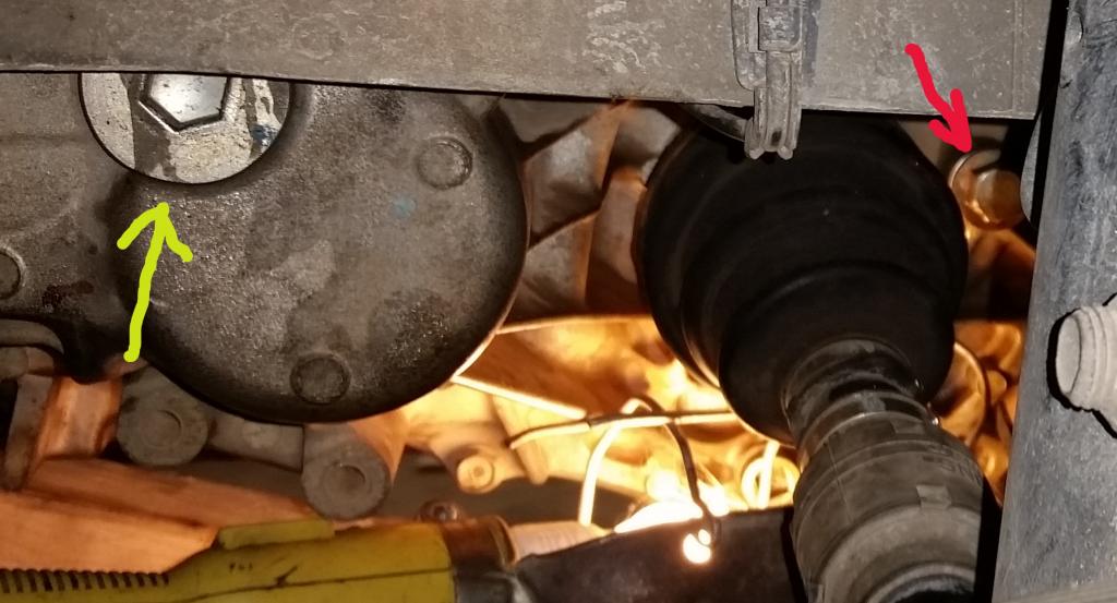

Ok I see it now, the one (red) I was looking at was this plug (yellow). Do you know what it is?

Rep Power: 518
Yes!
Yes I do. It's an access to release a snap ring retainer from the outer bearing on the countershaft.
Don't touch that until it's time to take the trans apart.
HTH
