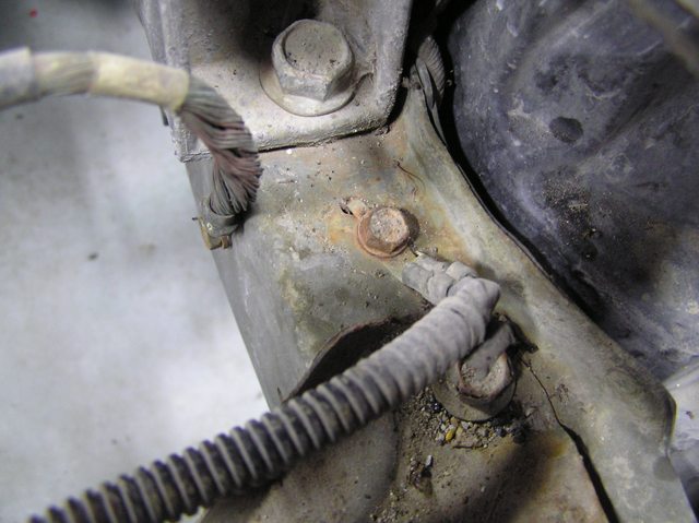

Follow the negative cable, check this ground point on the frame by the battery
Usually when it's the problem there is NO electrical power to anything in the car. Take it apart, wire brush the terminal, the bolt, the body, get it all shiny and clean, smear dielectric grease all over it and put it back together.

Re: Occasional starting problems
Originally Posted by ezone
What sound is that?
A truly dead battery makes no sounds at all.
For that matter, a battery shouldn't make any sounds anyway LOL
Starter just clicks, or car completely dead? Got starter? Test starter.
You need a fairly easy spot to reach the solenoid wire for testing? I got a pic of that somewhere.
If you can actually move the cable ends on the battery posts, they are not tight enough.
If it goes totally dead, a test light or voltmeter and some voltage drop testing while it's acting up can reveal the true cause.
That was where I believe my problem was!!!
