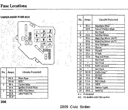

Copied from another post
(Engine compartment fuse and relay box, Left half of the pic) The relay in position #5 is the clutch relay.
