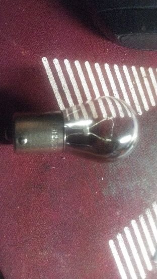

Thanks for responding. I'm still a little lost. The bulb I pulled out thinking it's the brake light bulb doesn't match the 7440 bulb at the store. When I press the brake pedal, the bulb on the driver's side light's up but not on the passenger side. The bulb in question that works on one side and not the other looks like the picture attached.

Well then. There's a difference between the sedan and the hatch of which I was unaware. I'll see if I can find a bulb guide that actually says what it's supposed to be
edit: apparently it's an 1156 (a.k.a. BA15S) bulb.
