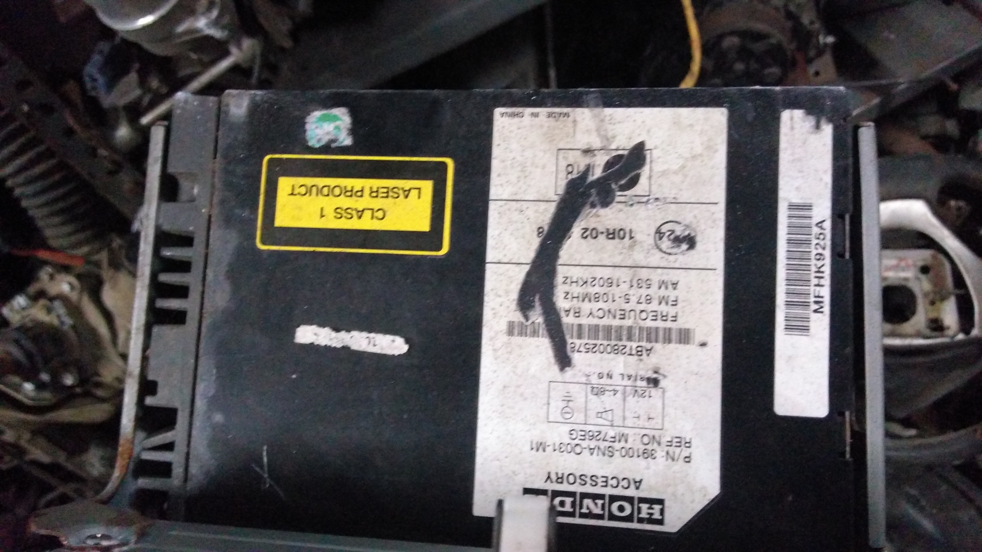

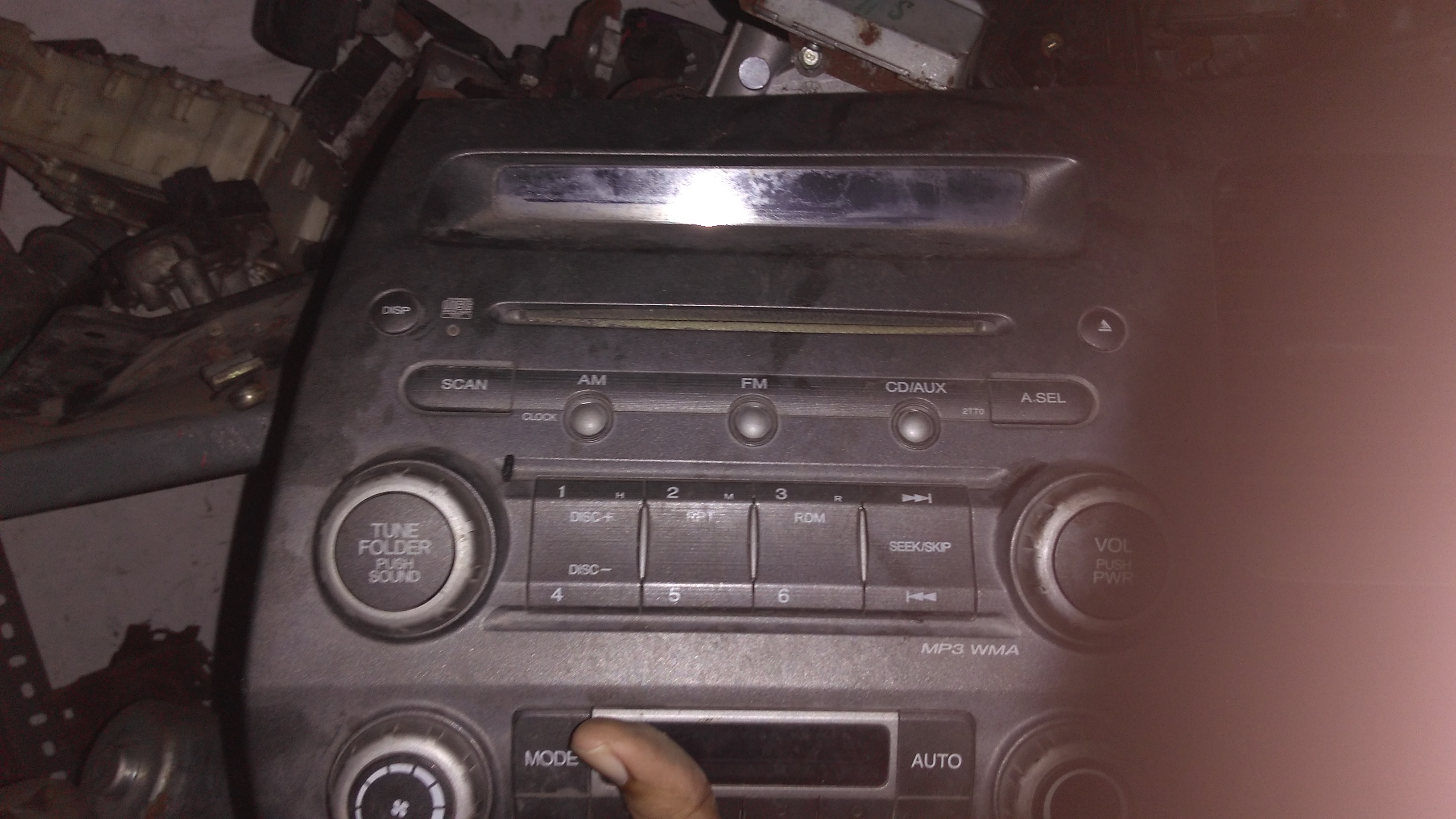

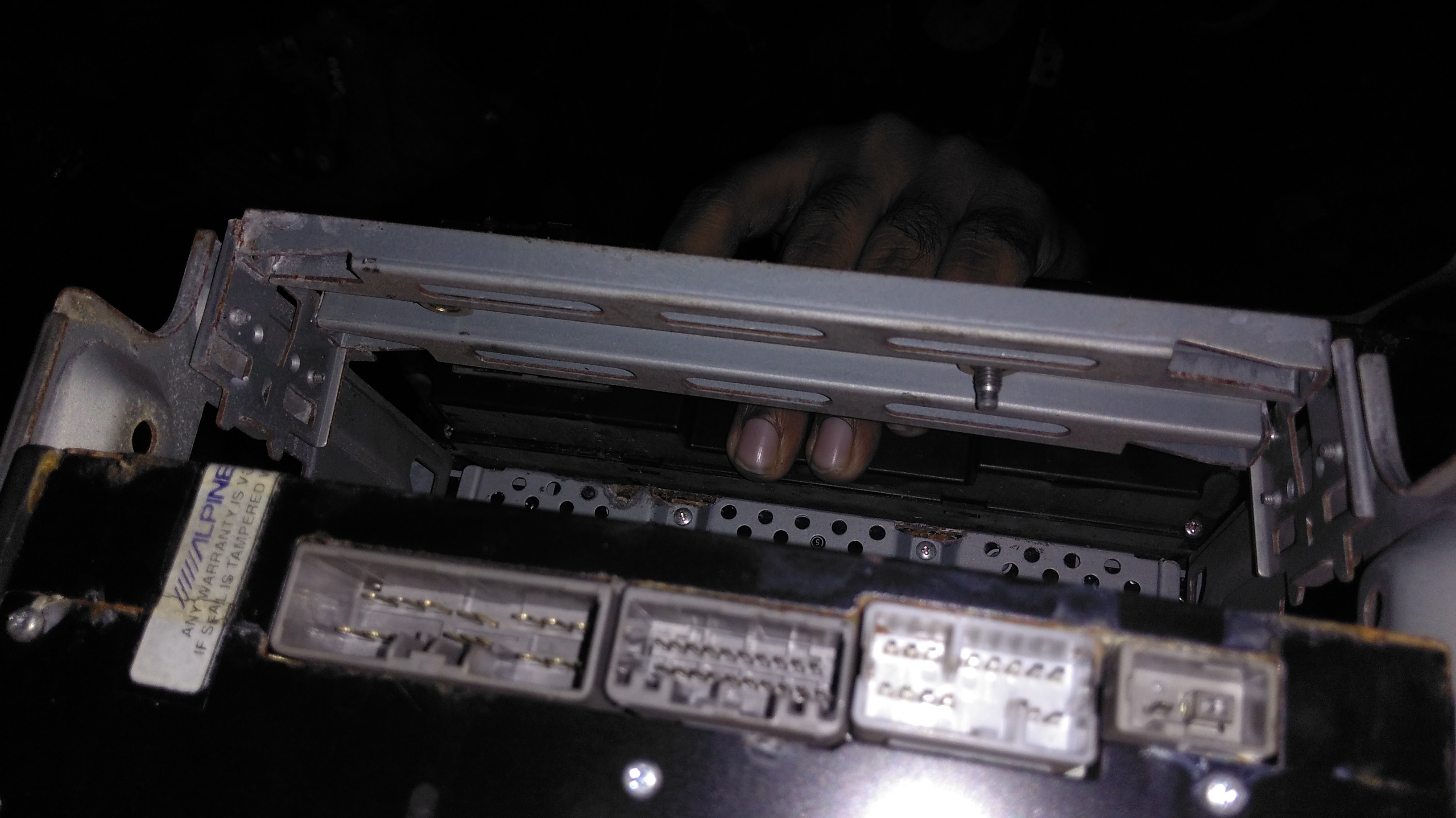

Anyway I am attaching the pics of the radio I saw at the junkyard. As you can see , there is no slot to connect a USB directly. But I am unsure, if the USB under arm rest can be connected to any of the 4 ports behind this radio by any means .. Thoughts?

That smaller connector might be for the USB but I honestly don’t know.
Did you get the radio code for the junk yard radio you pulled out? I think you need the VIN to recover it from Honda?

I know you are not in the US, and I only have some wire diagrams for North American cars. There were probably 6 different audio system configurations available on that model year, there were differences according to body style and trim level....so be careful and be certain the used radio matches your car.
The radio in your picture--the connectors appear to be in the same configuration (3, 14, 20, 17) as our "premium audio" unit which had the external amplifier. Make sure your old radio connectors are in the same order.
So are u saying there is a USB adapter and that actually does the conversion before the data goes into the alpine radio?
Correct.
USB--> adapter--> radio
My US diagram shows the adapter located under the front seat, and shows it having a 14 pin connector similar to the one on the back of the radio, and a 4 pin connector similar to a usb (actually 5 wires, 4 pins plus a shield)
If that is the case, radio in the attached pics might work with my USB port under arm rest,because adapter between usb port and the radio might do the trick.. make sense?
Your picture of the back of the radio shows 3 large connectors....On our radios the white 14 pin connector is for the USB adapter.
