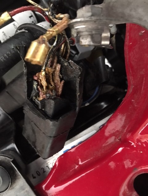

I have a 95 Civic EX Coupe with an electrical issue. My son crushed a coupler with 4 wires plugged into it. It sits next to an identical looking coupler and they sit above/next to the power steering pump and looks to run down to the a/c compressor. I need to replace it to fix a constant power drain.

Well...that used to be a relay, and it was in a rubber boot to make it weather resistant.
Carefully note the positions of all of the wires because you can't just stick them anywhere on the next relay. They have to go on certain pins in order to make it work right and not electrically damage other stuff.

Thanks. Two of the wires are pulled out right now. I know one of the wires is a constant hot. I guess I'll see if Honda can help with a wiring diagram when I order the part.
