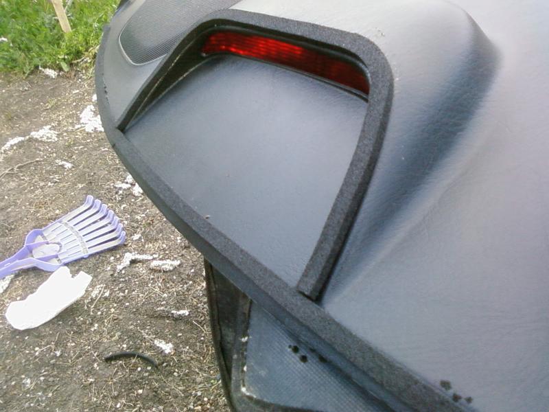

you don't actually need this Cd to fix the problem, but I got it from the dude at the speaker store, apparently it is an alpine test CD.
to stop the rattling on the rear deck I used foam tape
