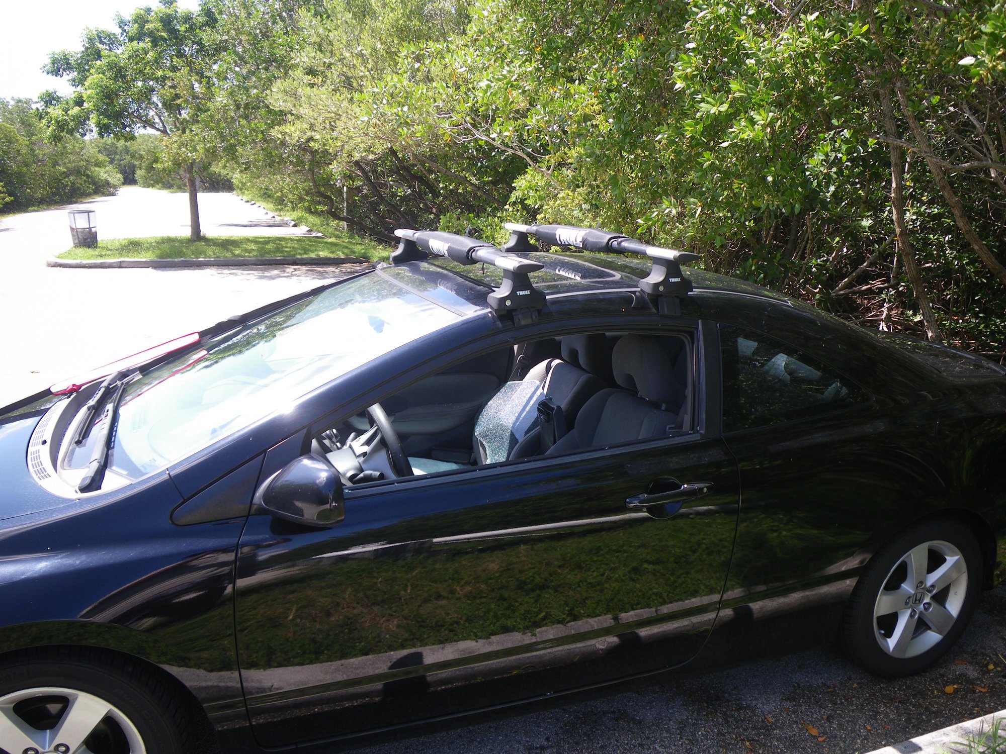

That is the only photo I could find with just the racks.. the windows are not open that day I came back to the launch site to find someone had raped my car and broke both driver/pass. windows out to get access...

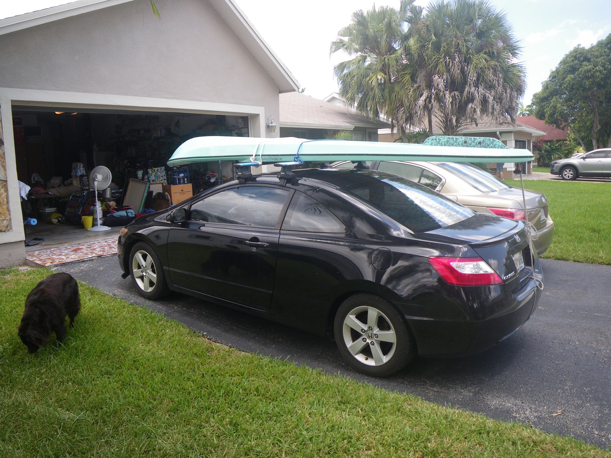

Here is another loaded and ready with the fishing SUP.
