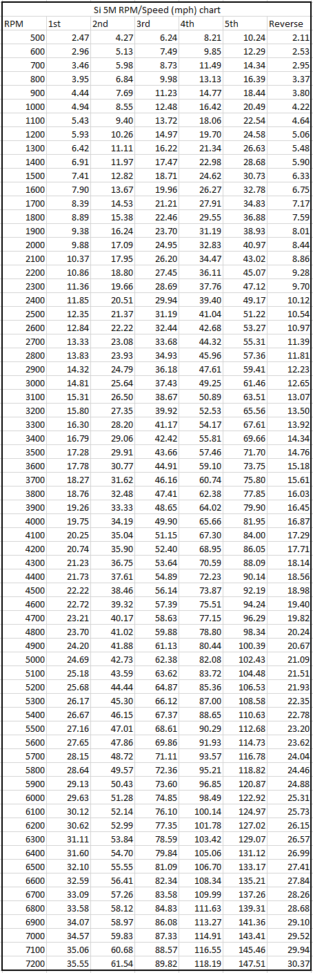

RPM and Speed Chart for 7th Gen Transmissions
In the last few weeks I have seen a few posts asking about expected engine RPM at certain speeds. Using the transmission gear ratios found on another thread and stock tire sizes this info can easily be calculated. I have created a chart showing the speed in MPH for every 100 engine RPM from 500-7200. There is a separate table for the auto transmission (EX/LX are the same) and for all the manual transmissions (DX/LX, EX, HX, and Si). All trims are USDM. If you notice any mistakes let me know.
Stock tire sizes used:
Gear ratios used:

Si 5M
1st----3.062
2nd----1.769
3rd----1.212
4th----0.921
5th----0.738
Reverse----3.583
Final Drive----4.764
RPM/Speed (MPH) tables:
EX/LX 4A
DX/LX 5M
HX 5M
EX 5M
Si 5M
