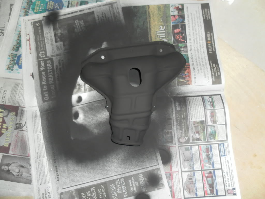

I painted mine flat black. It looked cool for a week. Like max said way too much maintenance.

Thanks, I'll just leave it the way it is. The heat shield looks fairly new and shiny still. I was just wondering if a bare header (painted) would be more attractive than the heat shield.

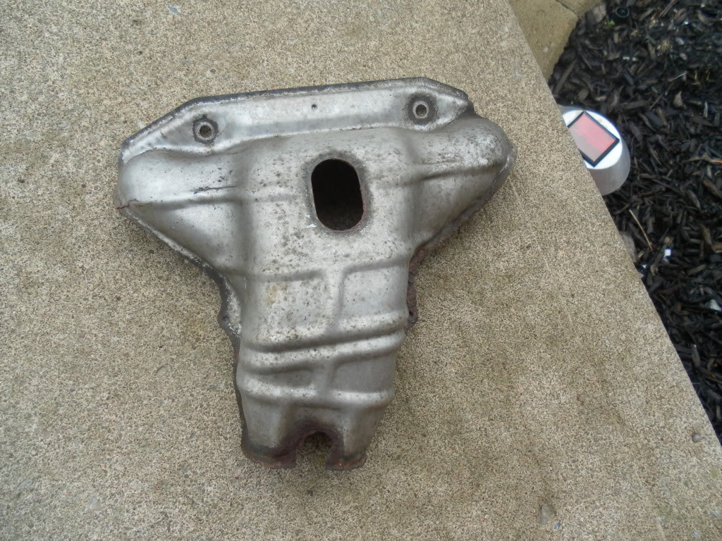

It probably would but that heat shield does serve some functionality. It protects your alternator from the radiant heat that the header gives off and some other stuff too. If your going to leave it exposed get it ceramic coated or wrapped. But in all honestly I'd just leave it as it is. The only reason I painted mine is because I had to replace it because of this:

I'm hoping the paint will protect it enough so that it won't rot out as fast. If it gets to that state it vibrates like crazy and makes a racket.
