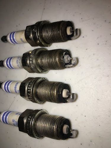

I just pulled these plugs from the 1993 Civic VX D15z1 that I just bought. I've been having some some slight hesitation with partial throttle issues and I wondered if new plugs would help. I pulled these out to discover they look way different than the recommended NGK plugs (these are Bosch) and I'm wondering what someone can tell me about my engine condition from these. Some have a weird white crusty covering on parts, some have a lot of carbon around the base. Do I need new spark plug gaskets? Any advice anyone has is helpful, thank you!

looks like its burning oil, make sure you're putting the proper ngk plugs in

Yup I just put the OEM recommended NGKs in and it was performing way better at first, now it seems to be about the same as it was. Is burning oil something I can fix myself with new spark plug O ring gaskets or would that be a repair like new piston rings?

oil control rings are probably all gummed up, you'd have to remove the pistons and clean them and replace the rings to do it properly
post 17 and beyond in this thread:
https://www.civicforums.com/forums/3...ed-engine.html
yours will probably look worse, but it gives you an idea of whats involved to do it properly.
you can try seafoam, and other products like mopar combustion chamber cleaner (super aggressive apparently)
or just live with it and keep an eye on the oil level

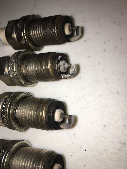

They look normal except for the one that has the dry, white discoloring on the anode and tip. Looks like a lean burn situation..possibly, a bad fuel injector? Do a cylinder drop (rpms) test by lifting spark plug wires one at a time and listen for rpms to drop while engine is idling.
Any blue-ish/black smoke with a burnt oil smell at startup emitting from the tail-pipe? Have someone rev the engine while you stand behind the car and look (and smell) for any abnormal smoke. Wait until engine is near or at operating temp before revving.
Inspect the air filter and replace if needed.
Inspect the PCV valve..shake it and if rattles (ball valve) it's working. If it doesn't rattle then replace it. Even if it rattles it's to spray some brake cleaner in it and shake it around to clean it out before reinstalling
Clean the throttle body with Throttle body cleaner spray (only) and use a toothbrush.
Do a compression test

Re: 93 Civic VX sparkplugs, what do they say about my engine?
Have you done a compression test? Is the odd one that cr4pped the plug lower than the rest?

Fouling on that one plug looks like it may be from coolant possibly entering the cylinder. OP..check the radiator and reservoir coolant level everyday for a week in the morning (cold start) before you start the engine. While you're at it check the oil level each day as well.

Thank you guys for the advice, I'm interested din trying the cylinder drop test but i can't find a video online that is like what you described so i'm still not quite sure how to do it.
And yes there is a slight exhaust smell on startup, but i don't have a catalytic converter and it's pretty much a straight pipe (ugh i know, previous owner)
I will test the PCV valve and come back with the results, thanks so much!

changing the piston rings on my daily is a little out of my wheelhouse at the moment. I would consider engine cleaner but i've read some very scary things about people developing engine problems afterwards, and about how much damage they do to all the gaskets in your engine. Have you had success with a certain brand?

Swapping the engine heads on the EM1 is already miles outside my comfort zone, and from what I've read changing piston rings is a whole lot more work. I did have a slight oil consumption issue on the EM1 (and blow-by?? carbon deposits on my back bumper above the tailpipe) but the shop that looked at my head also told me that one of my valves had not been sealing all the way, and those things can produce similar symptoms if I'm not mistaken. Could I get by just keeping an eye on my oil level or is it worth a bottom end rebuild? Same question goes for the VX

You can buy alot of oil for the price of an engine rebuild. Hell you could buy a used engine for less money than a rebuild.
The em1 probably has oil ring issues as well (it's common on Hondas) just not as bad as the '93.
Just monitor the oil level and add as necessary, if it starts getting to the point where you're putting in more oil than gas then you might want to do something about it. Oil burning will lead to shorter cat and o2 sensor life, but not super drastic until the oil burning gets really bad
