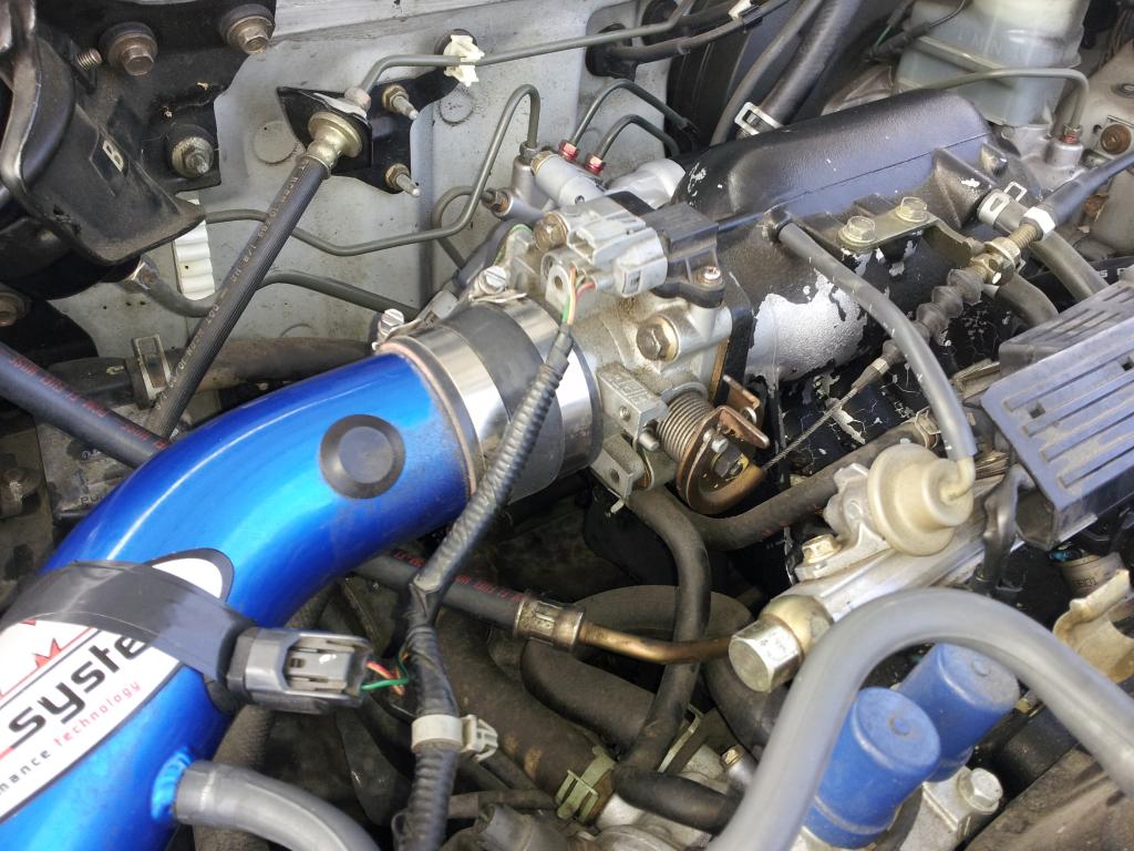

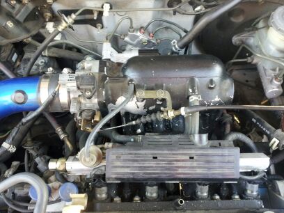

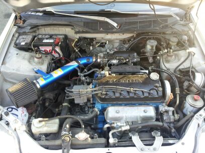

I have a '00 EX M-Trans with a D15b? swap. I got this car form my buddies tow yard, everything was already done to it and no previous owner to ask.
Im trying to figure out what D15 i have, what head is on it, what intake mani they have on it and the fuel rail. I have tried to research the net but am not getting anywhere.

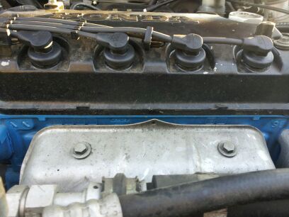

Head Code - (Left side) 604190524 (middle) P2J-3 (right) 96

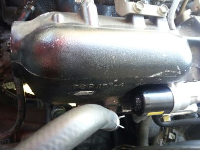

Intake Code - P2P 1PT-4

Any input or suggested links will be greatly appreciated.

Re: Trying to figure out what block/head/intake mani i have
Year - 2000
make - civic
model - Civic
trim - ? all power with sunroof
#doors - 2
engine - D15B - Previous owner swaped. Still has '00 ECU/Intake
trans - Manual
USA car, Canadian car?
D15B, no suffix?
JDM engine?
Wiki:
http://en.wikipedia.org/wiki/Honda_D_engine#D15B_VTEC
http://en.wikipedia.org/wiki/Honda_D...B_3-Stage_VTEC
The dual VTEC solenoids looks like their pic of a 3 stage VTEC?
I have no clue here. These were before my dealer time. Just going by the Wiki pages. I really don't remember seeing more than a single VTEC solenoid on any of the engines here.
This brings up a question: Are BOTH of your VTEC solenoids actually wired all the way to the stock 2000 EX M/T computer?
