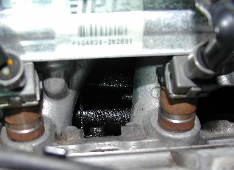

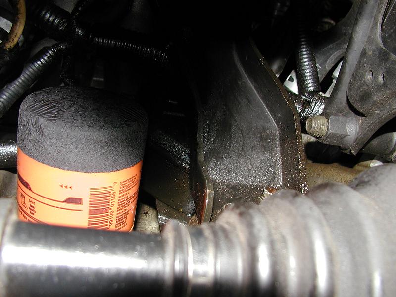

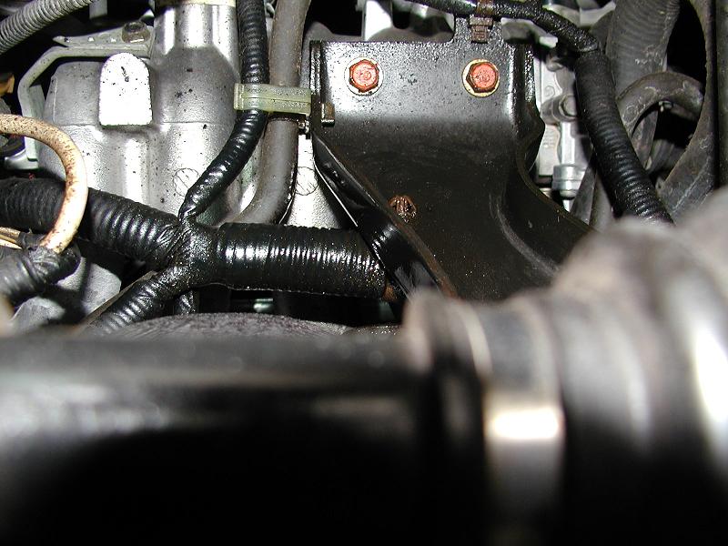

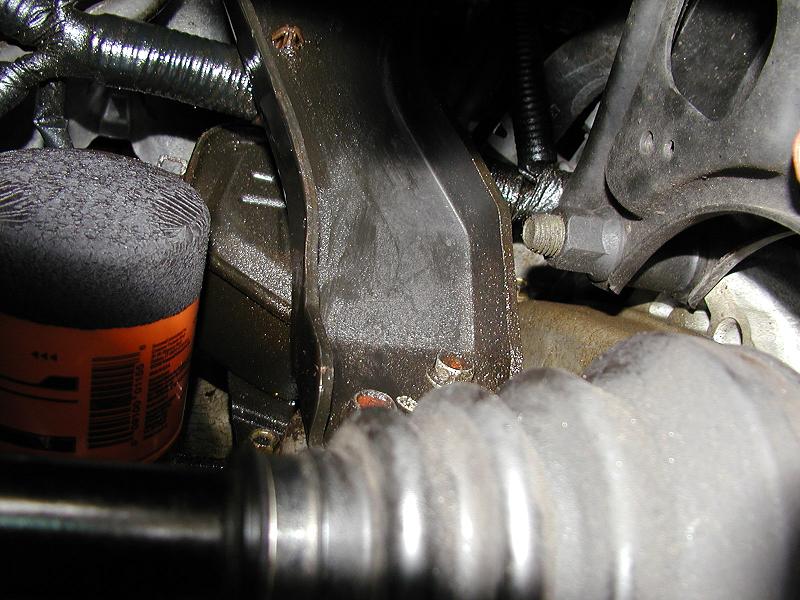

So after sealing the oil pan for the 4th time I took it out for a drive.
(this time I just used Honda bond, ran 2 large beads around the oil pan, torqued it down and let it dry for 50 plus hours before putting oil in)
Drove for about 20 minutes at highway speed. Pulled in the garage, and had an idle surging issue that I have been trying to figure out happen again. Spent a couple minutes disconnecting a sensor on the TB and disconnecting the battery to reset the code.
Looked under the car and there were already 3 or 4 drops of oil on the floor (less than 5 minutes)
Crawled under to look. Oil is dripping from the exhaust bracket that connects right behind the oil pan. There is a drop of oil forming on the pan below the front crank seal. There appears to be oil along the most of the back of the oil pan seal. Front is dry. The weird thing is that the oil is coming all the way down the exhaust bracket from the top. When I look from the top of the engine down through the intake manifold, the whole area is very wet (oily). Not just the dirty greasy mess like the rest of the engine, this looks like fresh oil. Although I am fairly sure the dizzy may be leaking there is very little wetness behind the lower part of the dizzy. This seems to be concentrated around the whole backside of the engine. There is even oil splatter on top of the oil filter.
What would be a likely cause of this much oil in that area? Is it possible that the oil from the oil pan could be blowing up instead of back?
I am just having a really hard time believing that I am incapable of sealing an oil pan.
The canister thing right above and to the right of the oil filter is almost dripping wet.
This is a non Vtec engine. D16B 94 DX hatchback.
There is no fresh oil to the rear of the oil pan on the car. All of the fresh wetness is above on the engine or at the top of the oil pan.
Also from the above pic taken above the engine, I am having a hard time believing that oil would blow that far up the engine.
Also the splatter on the oil filter appears to only be on top of the filter, not the bottom.

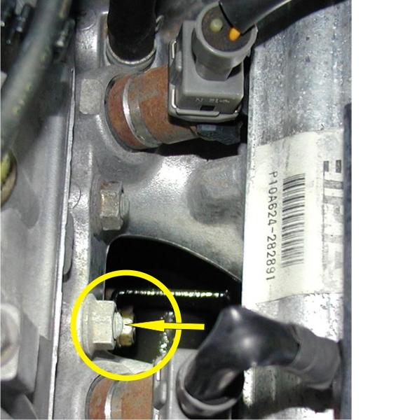

Well, after a couple more hours of cleaning the underneath side of the engine I was finally able to locate the leak. It is the head gasket.
I made sure everything was clean and dry underneath. Idled it for about 20 minutes and just barely say a slight wet spot near the top but wasn't sure if it was oil or residual water. Drove to the parts store for some oil dye, UV light and glasses. Dropped the dye in and drove home. Never went over 35 to make sure the oil didn't blow up if it was the oil pan.
Crawled underneath and saw more wet areas around the lower part of the IM.
Looked through the IM from above and everything was soaked again.
revved the engine while looking through the IM and sure enough, there was oil spraying out of the gasket. Was lucky enough to have it between the manifold ports so it could be seen. Now to pull the head, have it milled and replace a few gaskets. Thanks for the help everyone.
The attached pic shows the location of the leak.
