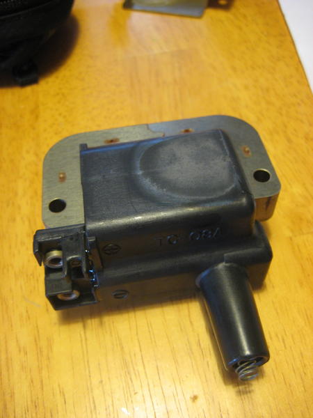

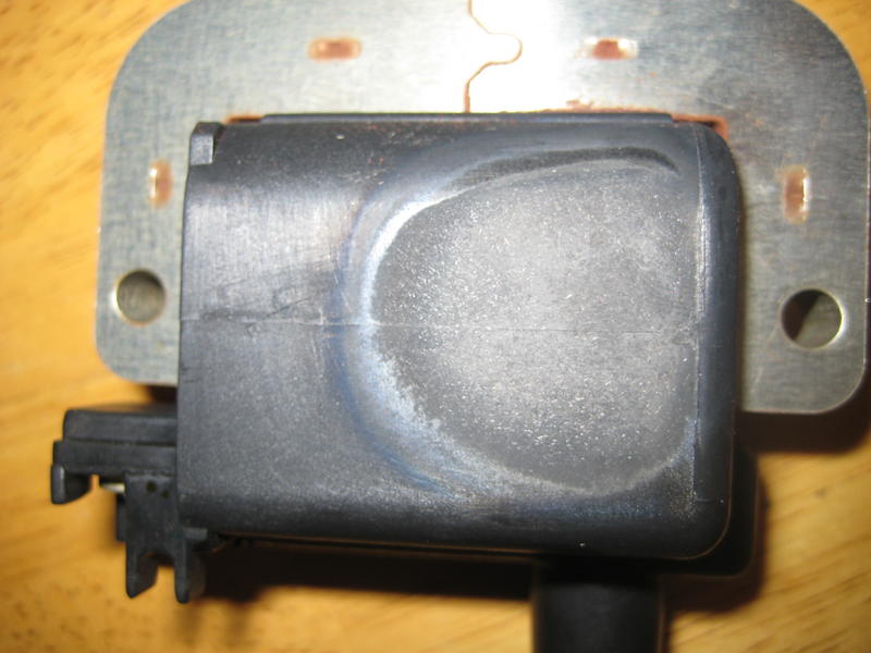

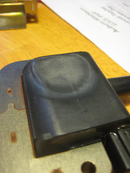

We found some pics on the internet of bad coils. One thing to check is take the coil out, take it off of the casing it comes in (that brass looking casing) and look at the sides of the coil (the black area). If you have arching or weird markings on the coil, it is likely your coil is bad! Mine looked worse than the ones we saw online! Apparently this is a very common problem for honda distributors. I will post a picture of my coil on here soon so you all can see for yourself. Basically, the coil wears out over time, the wires inside get old or corroded. When this happens and your car warms up, pushing all the volts through your corroded coil, the current struggles to find the correct way out of the coil and instead flows out the casing, making the weird markings. This is what causes the distributor to lose its current, which then shuts the engine down or misfire.
BAM - replaced the coil for $80 (OEM equivalent). Took back the $200 distributor. Also did the rotor since it looked a little burnt.
It's been 1 day - so far no problems. I'm crossing my fingers, since this problem has been intermittent and may very well come back. But we're very confident that this coil was the culprit. It looked fried. I will post a pic.

Since I've replaced the ignition coil about 3 weeks ago, I have not had a single misfire! Looks like I solved the mystery.
Don't go out buying a distributor or paying someone a ton of money to replace it for you. Check your ignition coil first.
Check out the pics of my fried ignition coil. You can see where the current came out of the chamber and warped the casing.
