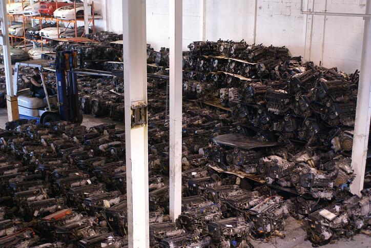

Well your options are only limited by the size of your budget.
In a perfect world were we all had unlimited fundage, a k20 swap would be a perfect deal. But the life on the motor you already have is basically, just broken in. If your talking about boosting the d16, well you would (in my opinion) be a lot better off spending that loot on a b-series swap. If you were really leaning towards a turbo, put that on a b18a motor. Due to the availability of the non-vtec powerplants, these can be rounded up for pretty cheap. You could then craigslist the motor/tranny you already have to get the funds up. Keep in mind that staying in the non-vtec realm, you can essentially re-use the same engine harness,with very little modification(just adding length to a few wires) saving some cash in the end.
The k-swap rules if you've got the cash, but 9 out of the 10 folks that will read this don't.
Hope this helps,
Brad
