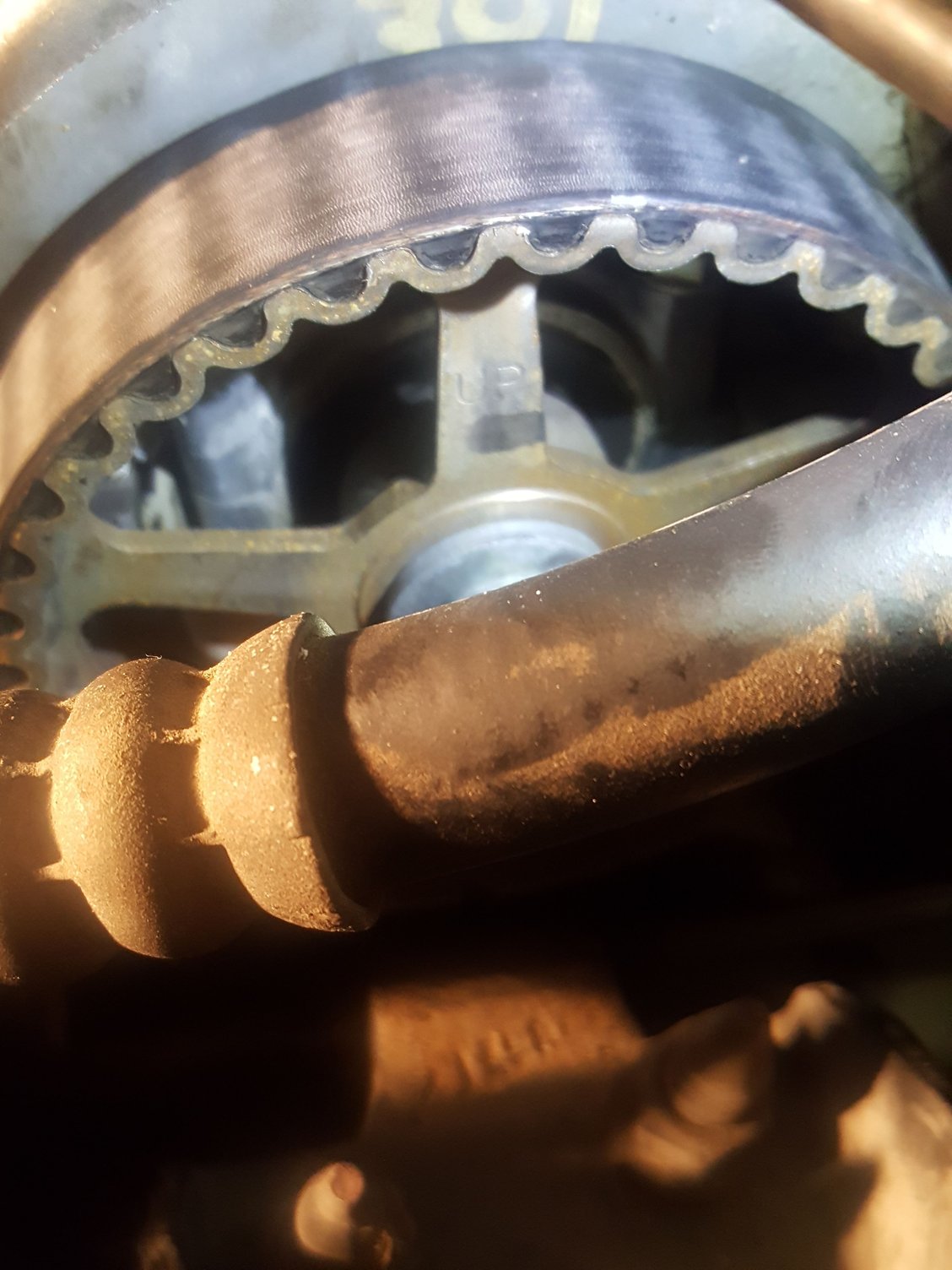

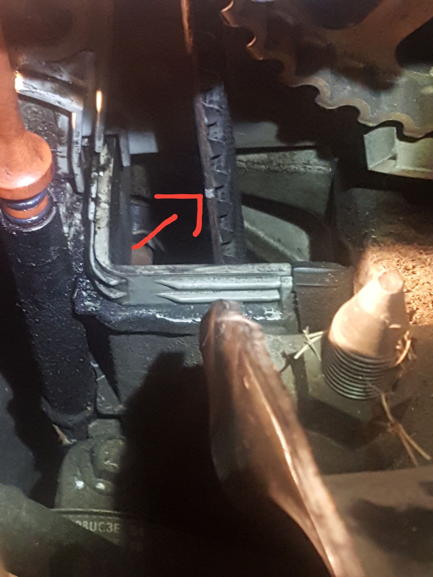

First post, please don't yell at this point im desperate haha, help!! So here's the run down, car died while driving I'm getting a weak spark at the ignition coil spring. I've replaced the coil, tested the igniter (getting power via my test light.. could still be shot??_), replaced the distributor cap, plugs and wires, checked out two different kinds of rotors, put the old wires and plugs back in incase they sold me the wrong plugs. I have set the timing to TDC but I still think it's off? Slipped teeth? In the pictures I provided you can see a white mark on the belt but I think it may be just a smudge? The cam and crank pully marks are both lined up. Also the fuel pump is kicking on and the line doesn't seem to be clogged and seemed to have plenty of pressure when I broke the nut loose and let it spray some. I've replaced the main relay, checked all fuses. Uhhh, I think that's it. It did run for a few seconds until I killed the battery after replacing all of this until I killed the key. Also the car abruptly died while driving.

No marks on the timing belt. Your only guides are the TDC and timing marks for the pulleys.
If you can't quite see if the cam pulley marks aligned with the head surface or arrows, grab a small mirror (makeup mirror works)

The marks looked good...are you set at TDC for cylinder very 1 or cylinder 4...compression stroke...why I even have to say it I don't know....should be on TDC 1...
