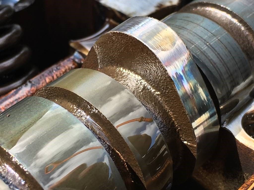

The machine shops described the marks on my camshaft and rockers as "gouges from lack of lubrication" maybe some ******** before me forgot to put oil in it and drove it around the block or something. My problem with what they said is the fact that the car performed perfectly before it was taken in (I've driven it more than a year, and on many long long road trips). I told the mechanic that I can't imagine my head was warped a little if it at all, it only got maybe 3/4th up the temp gauge before I shut the car off, topped it off with coolant, and drove it to the shop (10-15 minutes) without any overheating. They decided that the head gasket was bad because of a test they performed that tested for oil in the coolant, aka a head gasket leak between the two passages. I accepted this because I had put in a new radiator and flushed the coolant a few months earlier, so I was fairly confident there wouldn't have been any other problems with the cooling system
Here's a quote from my email correspondence with the mechanic that was working on my car.
"Here is what we are dealing with, the cam lobe that is up is scored (see the scratches and blue/rainbow color) it should look like the lobes next to it with just sort of a medium shine on them no scratches and no bluing.
The machine shop said yours has multiple lobes that look like this. They said the camshaft and rocker arms are very worn the machine shop said the cam lobes are scored and blue from heat and the same with the rocker arms. The machine shop has not seen anything like that before, he suspects it got very hot."
And it was running fine like that.....
Don't you have the car, the cylinder head, and the camshaft and rockertrain there at home now, and you can inspect it all? Can you confirm what they are trying to tell you?
Post more pics?

Yes I have all the parts, I looked at the camshaft and yes there were some marks on it, but to my unqualified eyes it didn't seem like anything that couldn't have kept the engine going for another hundred thousand miles. So to me it sounds like greedy mechanics ready to condemn a car before it's time. I can maybe post some pictures later tonight Thank you so much for your input ezone!!
Some wear at 240k might be expected? I can't tell from here yet.
What's the corresponding follower (rocker arm) wheel look/feel//spin/wobble like?
(FWIW some of the cam lobe issues I have seen in other newer engines have been blamed on improper hardening processes when the cam was made.)
Maybe they were just covering their butts in case the wear they noticed became a bigger problem....you know, most consumers will automatically blame the last person/mechanic/shop whom touched the car when something new goes wrong.
OTOH, maybe someone took the head/cam/rockers all apart and lost some small but critical pieces...
Haha maybe so, I'll try and inspect the rocker arms later but I'm not sure it'll lead me to anything conclusive, after all I'm not worried about going after the shop or anything like that, my focus is mainly just getting this car running again well enough to be my daily.

Those guys are full of ****, there is no way they didn't find a good cam shaft. I doubt even with the marks on the camshaft you have, you would even need to replace yours (take it to a shop and polish it if you're worried about metal shavings rubbing off).
The cam shaft just rotates and pushes down on the valve assembly, as long as it can do that you're fine.
The reason bearings are replaced on other parts like the piston rods is that if those are too scratched grim can build up and grind away material which is bad for a part that is shot up and down with tremendous force at 7000rpm. If the play becomes too large, then while rotating the play in rod bearings can cause rod failure.
Camshafts on the other hand just rotate.

Interesting, thanks for the insight! The way they explained it was that as the cam lobe became more worn and more material was ground away, it would eventually not open the valve less and less and make the car perform worse until it wouldn't work anymore. Seems far fetched to me but I didn't know better at the time
Old Feb 2, 2018
Re: I need help saving my EM1 (engine head reassembly)
Post some pics of it so we all can see it
