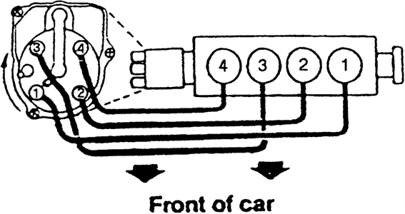

Firing order correct? 1-3-4-2 around the cap? Ordered in the right direction too?
I know I’m gonna sound dumb but how do I go about checking that? Could possibly be the issue. Ik spark plug wires are in the right places and timing is correct

Re: Please help, need to be in sc rn
Goggle image search it
Might be like this
