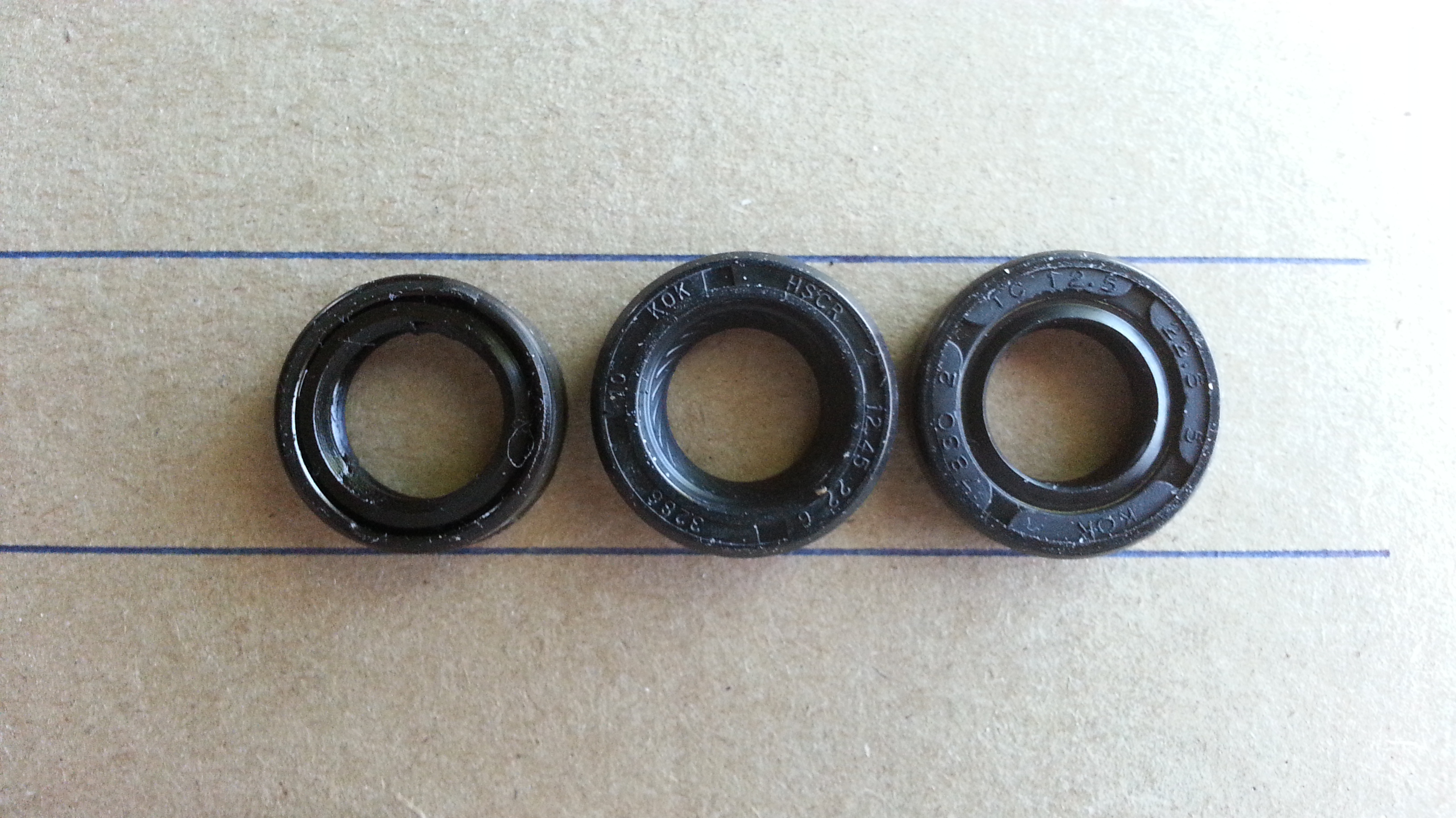

Recently, the distributor started leaking oil, so I ordered a seal kit, and studied up on how to remove and disassemble the distributor myself. However, when I went to install the new oil seal, it was too big! Turns out the distributor they put in was an aftermarket Power Select/WTS DST-17420 ($130 at Rock Auto!!), which uses a smaller diameter oil seal than the OEM distributor.

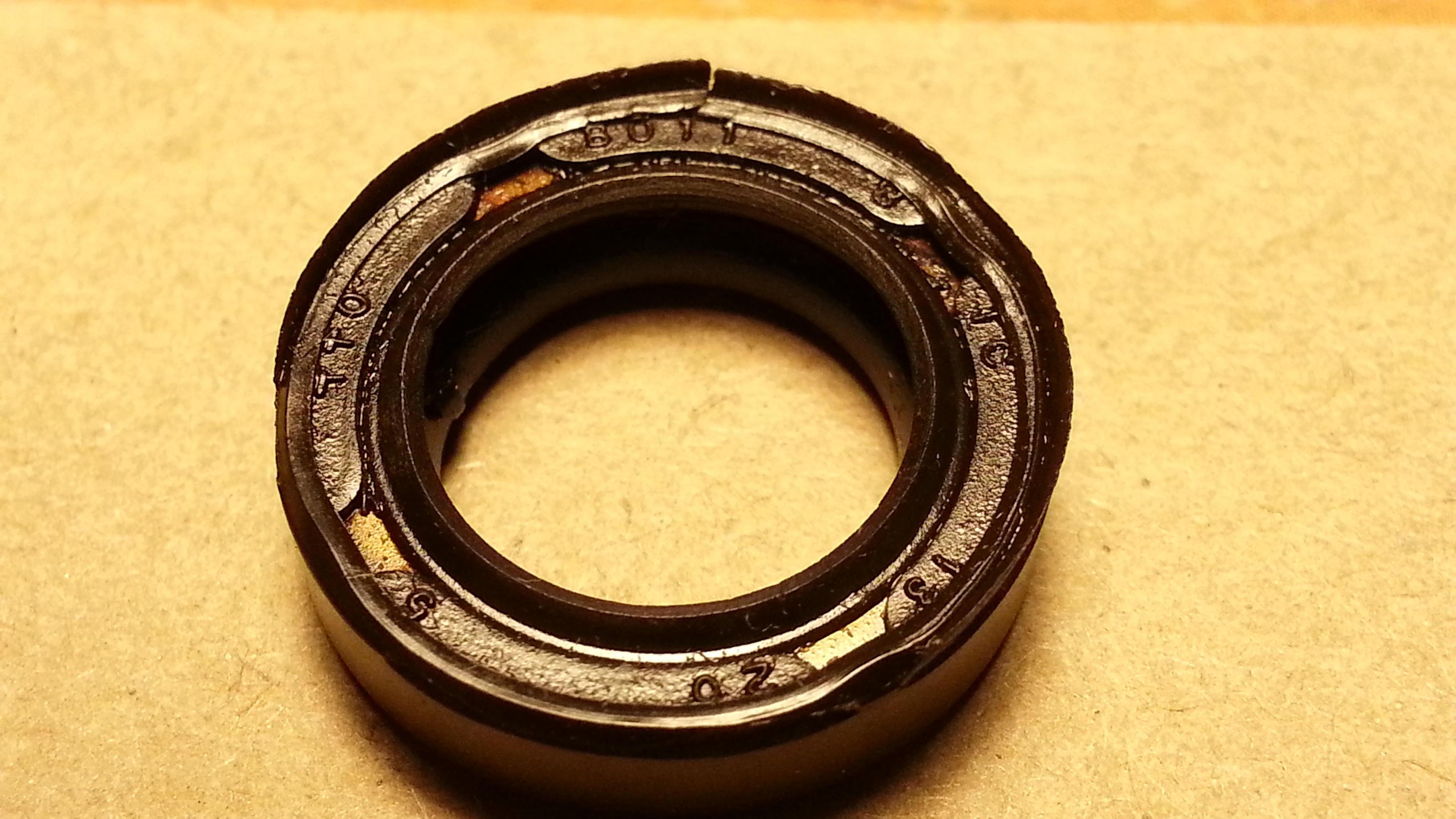

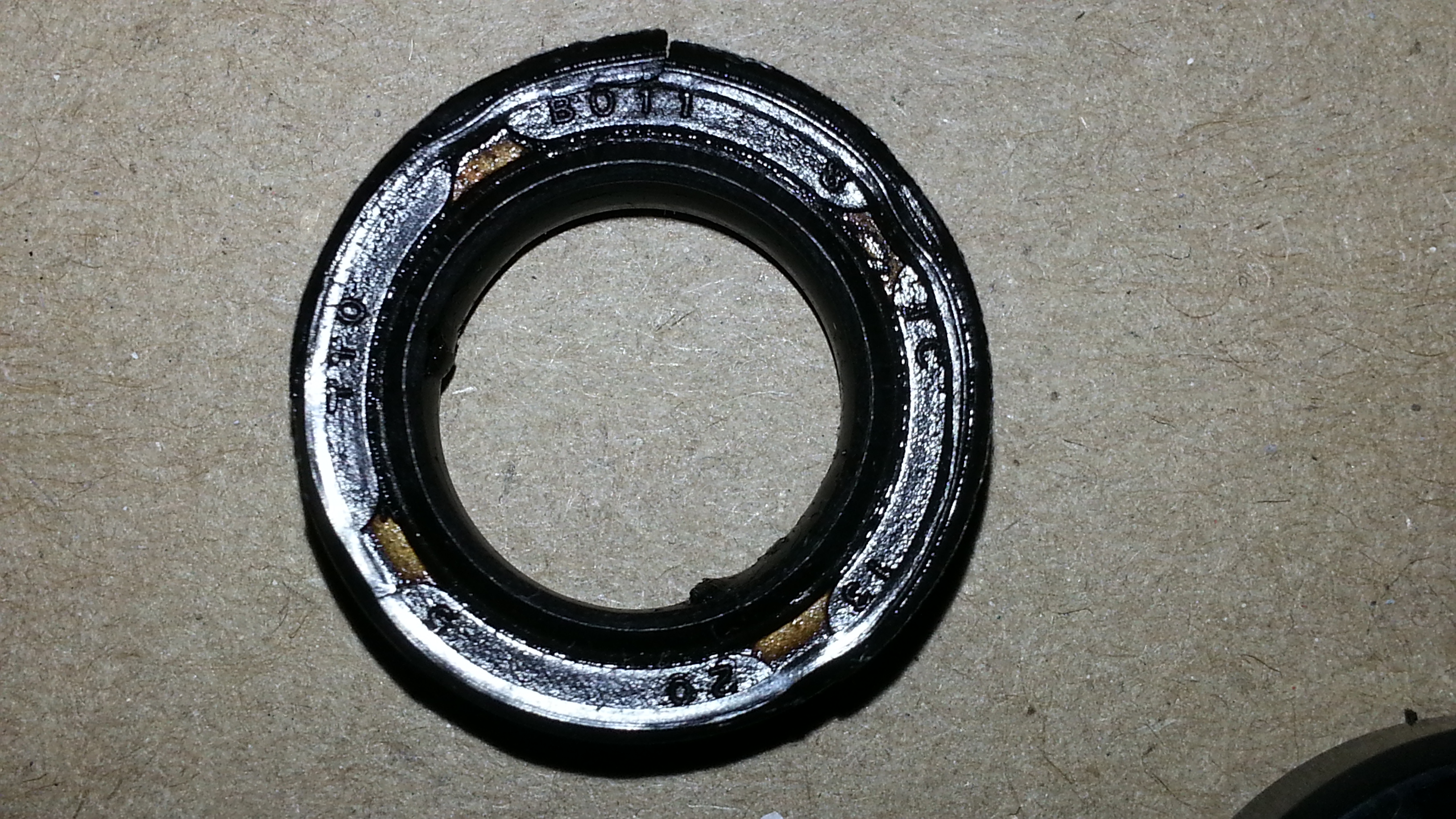

So, I need your help identifying the seal (emailing the company hasn't helped), as there seems to be no brand name on it, only: B011 8 TC 13 20 5 TTO. I attached pics to help.

Measure the interior diameter and google it to find a replacement part number; then take your old seal with you to a parts store and use the part number you googled to find a replacement.
