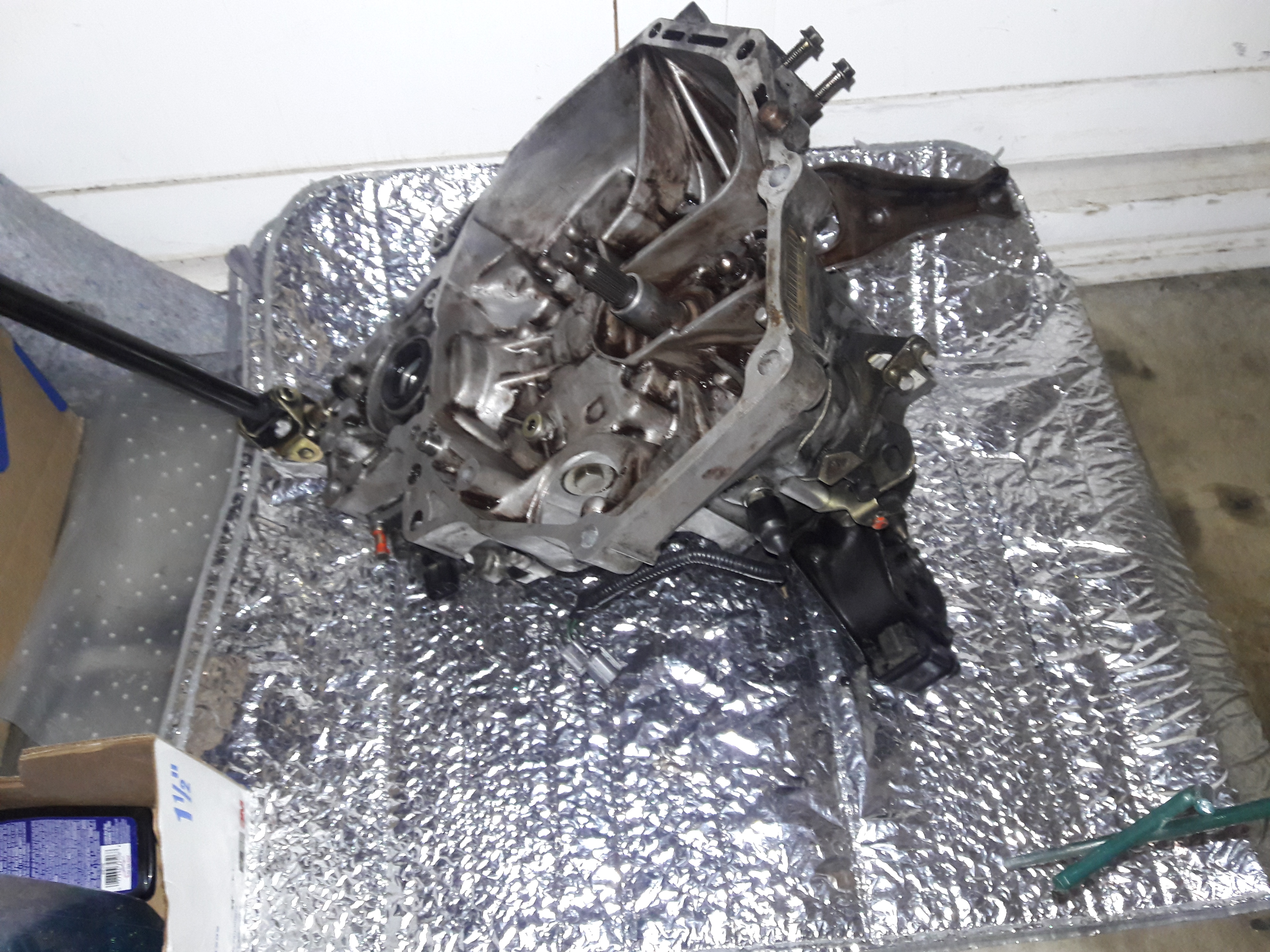

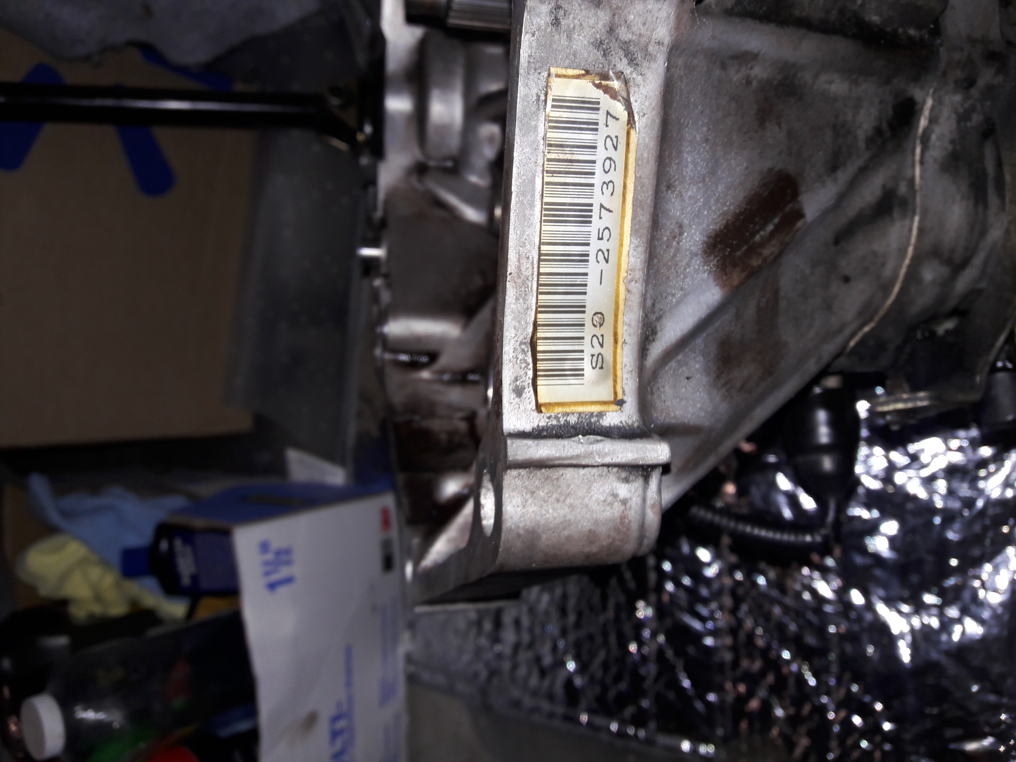

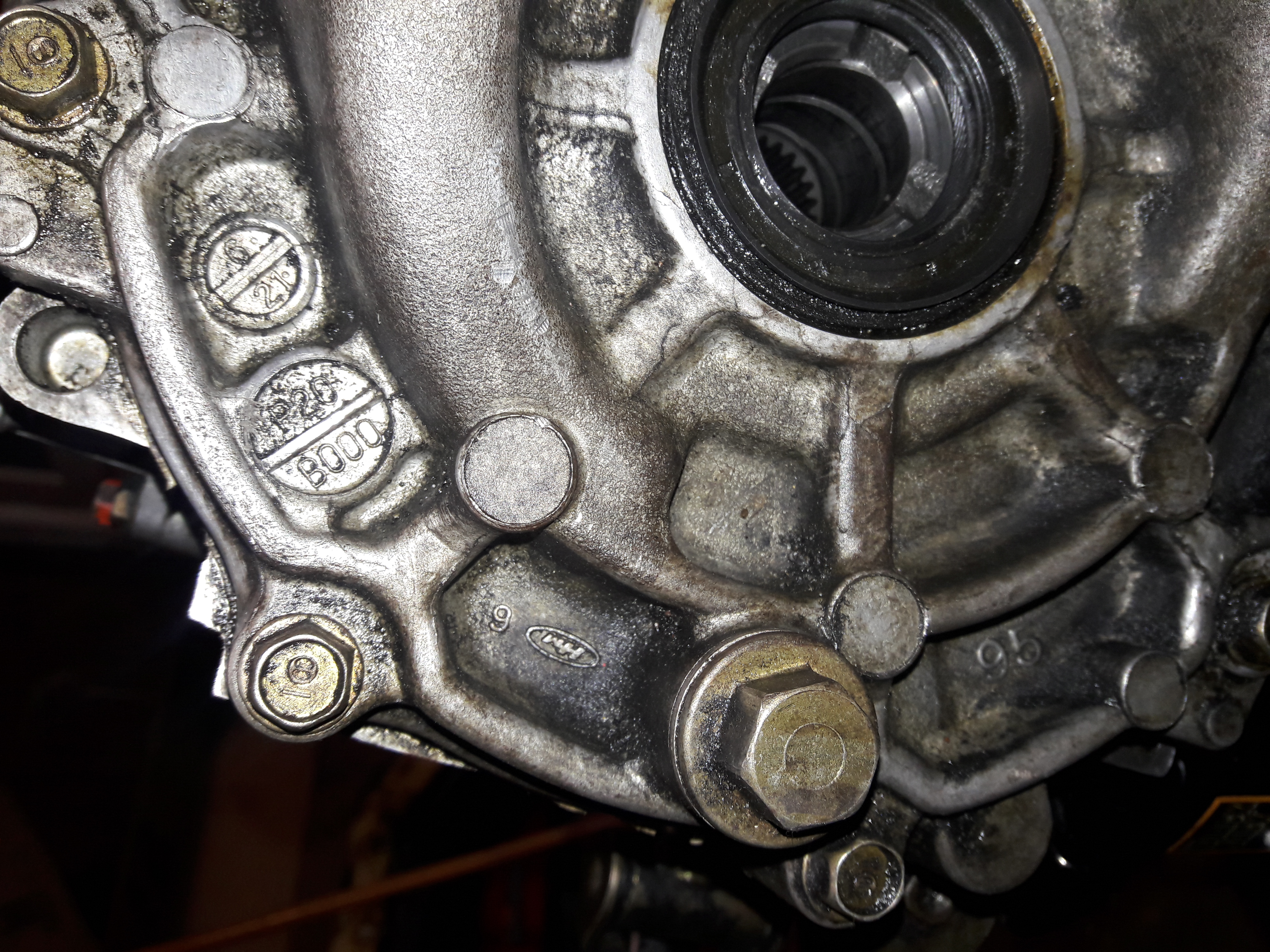

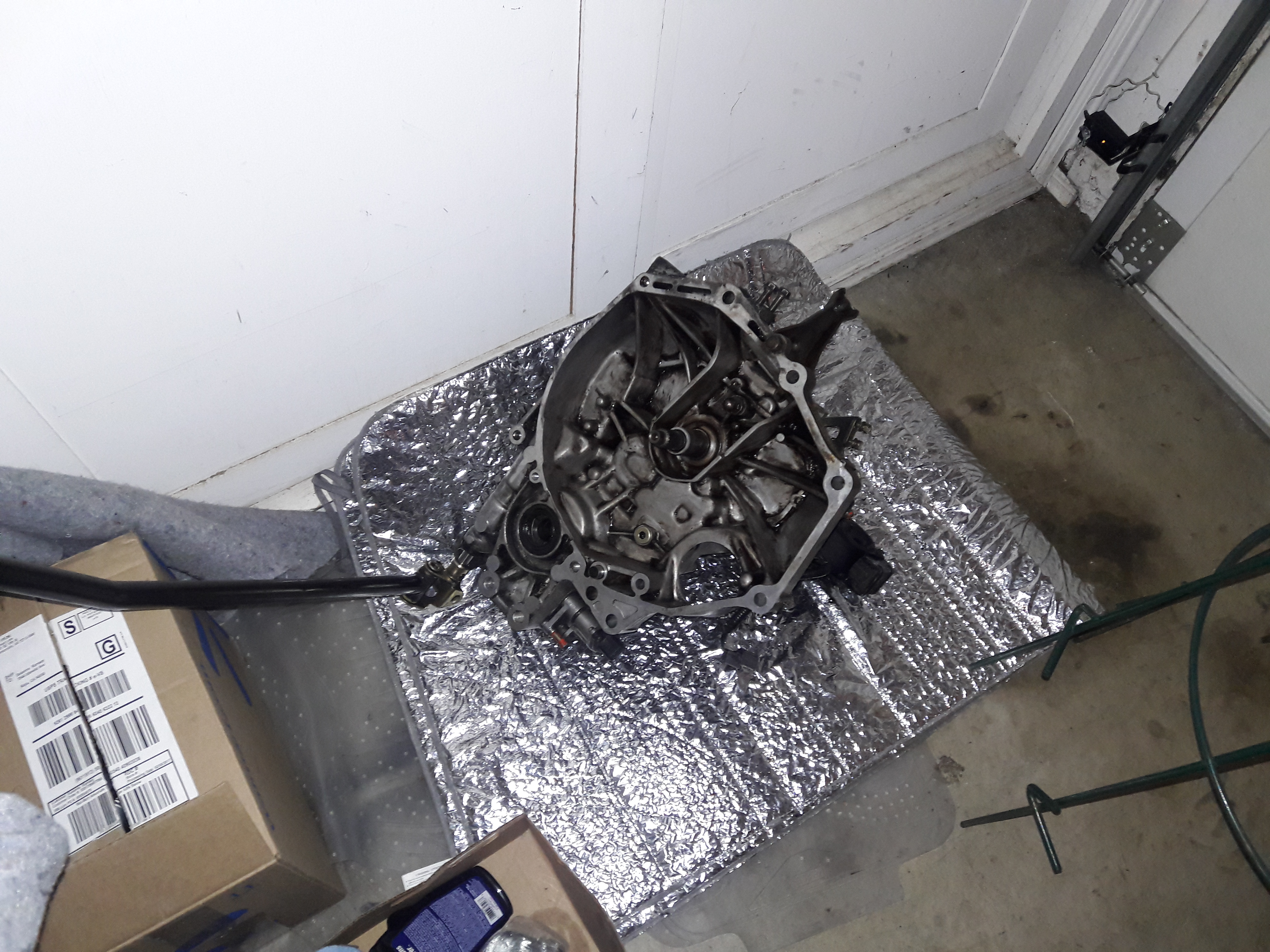

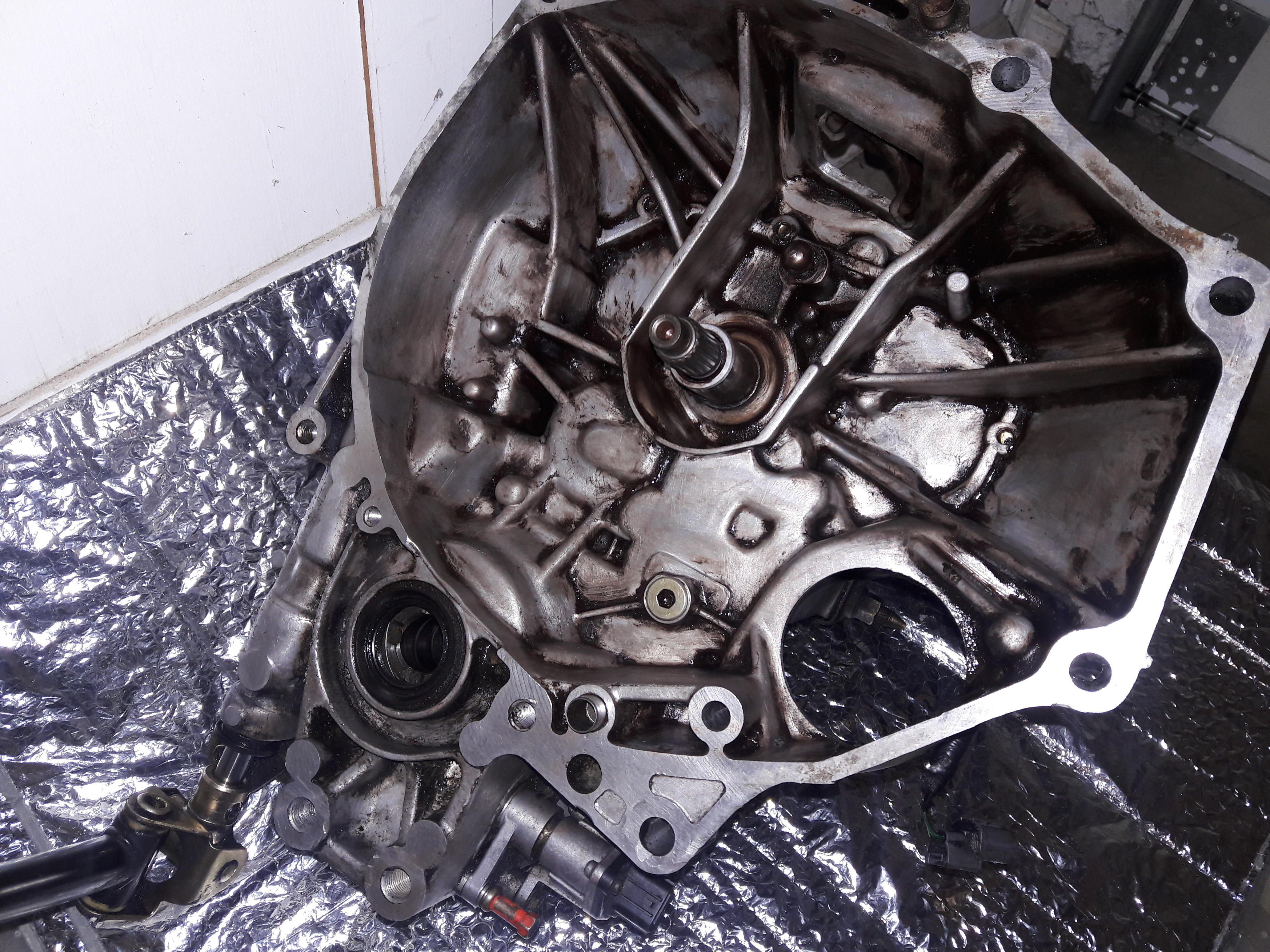

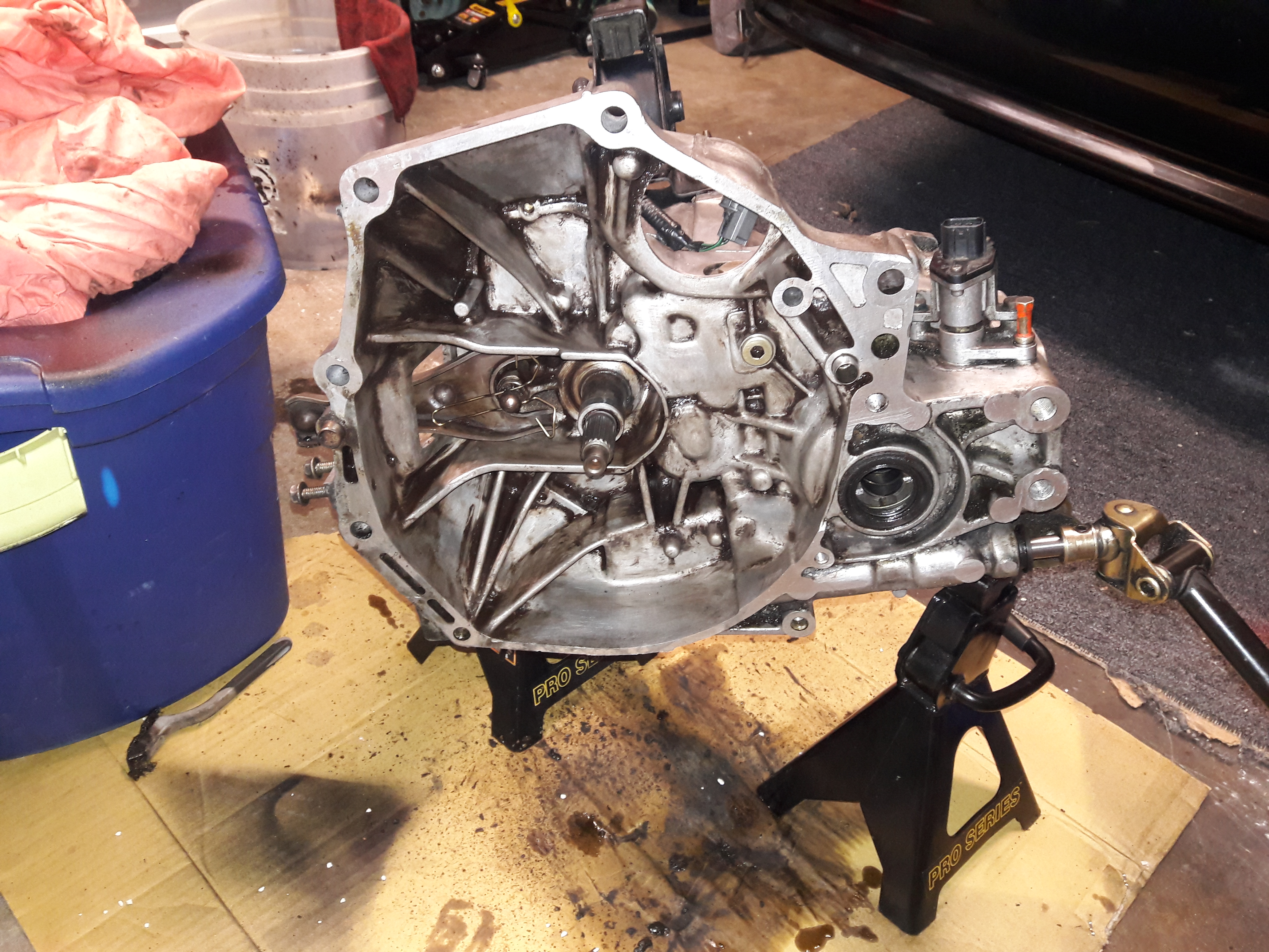

So here is what I have sitting in my garage from october. had planned on a z6 head with 5 speed swap from a 95 si..sold the head and left the tranny in the corner.. Took a look at it today googled the numbers on it wiped it down etc. Can anyone tell me anything else about this transmission..yes i know its missing throwout bearing etc etc. but money wise would this 5 speed bolt directly to a y7 bottom? Of course with some modification i would think it could? As it stands right now I'm toying with the idea of ordering a rebuilt z6 head, check the block/ new internals maybe and call it good..Need any input or something...Its one of those days where I have no idea what i want with this car anymore haha. some pictures of transmission below:
Numbers on Transmission s20- xxxxx y4f p20 and B0000 (si?)

is that a b series tranny or a d series tranny?
if its a b series I don't think it will, but a d series should

Alright it is a D series that I'm positive. Ive searched around and s20 is from 92-95 models..the B0000 stamp identifies it as either ex/si..
so now i guess my questions are 1) will it bolt up to my 00' d16y7 (replacing auto) and 2 besides the obvious missing clutch flywheel and throw-out bearing I have no idea what other pieces are missing...haynes doesn't break the transmission down that far piece by piece

It should bolt up, all the d series have the same bellhousing pattern if I remember correctly.
You will need; flywheel + bolts, clutch, pressure plate, throwout bearing, slave cylinder, master cylinder + lines, pedal assembly from a manual car, ecu that will match the engine and trasmission type, wiring harness for the same, shifter + shifter rods, mounts, axles. And possibly some other things that I cant remember at the moment.
Your best bet would be to either buy a manual parts car, or find a good you pull scrapyard near you.
And in all honestly you might be better off selling that tranny and finding a y7/y8 tranny, either in your parts car or elsewhere. that way you know it fits for sure
