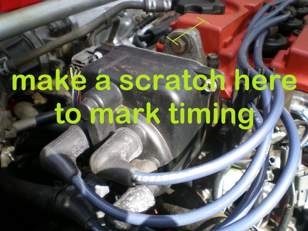

Make a reference alignment mark on the leg of the distributor base across the casting sticking up out of the head, so you can get the dist reinstalled and aligned in the exact same position it started before removal.....this way you don't have to retime it with a timing light.
I sometimes use a chisel to make the marks, it's quick.
Maybe someone has already marked yours here.
A single mark is good enough, when you get a bunch of lines on here it can get confusing.
Remove distributor, replace O ring.
When you go to reinstall, push the dist into the hole gently, then rotate the rotor slowly to align the drive lugs between camshaft and dist end, when you get it in the right spot the dist will easily go all the way into the hole and seat flat against the head.
It will only go all the way in one spot. Do not force it.
