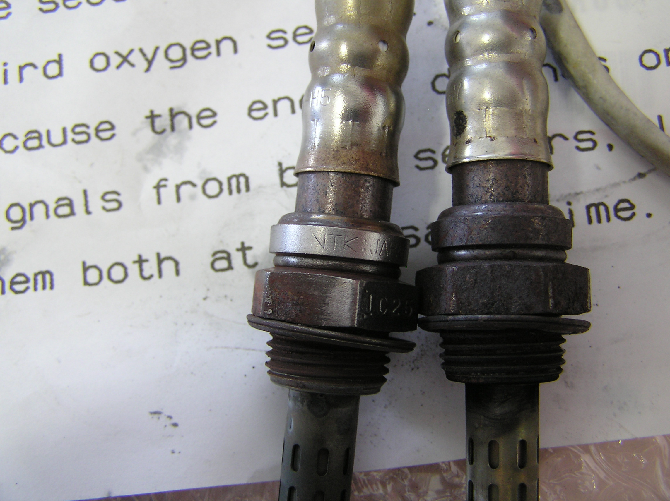

Here's a pair of sensors I removed from a Hybrid. One has been cleaned with a wire wheel and you can read the name easily, the other is still covered in crap.
Yours may or may not be the same brand....and IDK if the Denso brand stamp is in the same location--it may be on the upper tin covering
