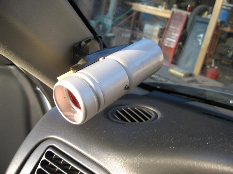

Just bought a 2000 civic and this is on the dash

Looks like a shift indicator light
Old Nov 15, 2013
Re: What is this
Or a redline light, or oil pressure.....
It's a big freekin' warning light, meant to get your attention! (Usually when something BAD is happening.)....If this had been a real race car, that light would most likely be hooked to the most important things to keep an expensive race engine from self-destruction.
Oil pressure and redline are 2 real important things when you are racing, IMO.
It's probably a warning light for whatever it is connected to. Follow the wires and find out.

It comes on when you first turn on the ignition , then goes off, then when you turn it more so the car starts it goes on again then it goes off again

That wasn't very helpful yet.
Which idiot light on the dash does the exact same thing as the light on top?
Or, which idiot light in the dash is now inoperative because its wire now goes to the bigass light?
Does the original oil pressure warning light still work?

OK I'll check it out, by the way I'm willing to look dumb to get a answer
because it really doesn't hurt that much.

I wasn't trying to...... I was thinking the likely thing a normal person would connect it to (on an unmodified car) would probably be the oil pressure light.
Associating it with a regular warning light (with proof) would be easier than actually tracking down the wiring.

Looks like a shift light. Similar to this, just maybe not adjustable:
http://m.dhgate.com/product/adjustab...67.html#pd-112
Redline the car and see if it comes on. Could just be a lamp hooked up to something important like ezone said.
Did you buy it from a young kid who thought he had race car?

Easy way to figure it out: contact whoever you got the car from and ask "wtf is this thing...?"

I'd do what ezone suggested then. If you have the time, pull plastic trim off and trace the wires, see where it taps. The use the power of google to find out what it taps into via the color banding on the wire.
To me, it screams shift light, but that doesn't quite line up with when you say it illuminates.

That's how most people hook up a shift light, or a red line indicator.
For all we know, it could just be a big *** CEL.

I'm just used to seeing a lightsaber-esque shift light accompanied with an obnoxiously large tach.
Now I'm genuinely curious as to what its function is.

I'm not use to these high winding engines, I tried to run it up to red line and with this exhaust system it sounded like it was going to blow up, so I chickened out. I'll have to wait till I have some time and a nice day to follow the wires

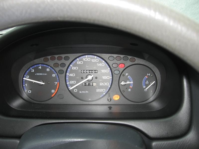

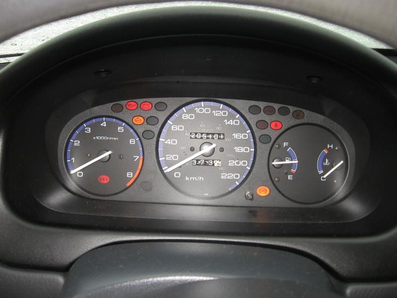

Just to try and be a nice guy I trudged out through 6 feet of snow to my car and checked my 'idiot' lights. lol
Ignition 'on' (2nd positon) oil - bat stay on until started - check engine - srs - abs come on and go out and at ignition abs comes on for a second or two.
I can't imagine it's an ABS light but that behaves almost exactly as described

Another thought comes to mind, maybe the PO was a forgetful person, and it's a big *** seatbelt reminder light

A little research,
And I'd say this is pretty much spot on, wouldn't you?
[Youtube]https://www.youtube.com/watch?v=hj2-MnYd2Nw[/Youtube]
http://www.glowshiftdirect.com/silve...red-light.aspx
I'd dismount it, or look on the back through the front windshield to see if there's a dial to set the RPM limit for the light to go off.

Yes it has a switch for 4, 6 or 8 on the front .It has to be a shift light

I still say you trace the wires, just to have definitive proof instead of speculation. But that's just what I'd do.

Or adjust dial to 4, and rev it up to 4k to see if it turns on. That'd give you a quick indicator.
If it doesn't light up, then you'll have to do some tracing.

4,6,8 sounds more like the # of cylinders to me. It actually rings a bell for me as a cylinder count but too long ago to remember what it was.
Obviously this car doesn't have a tach in it to begin with?

4,6,8 sounds more like the # of cylinders to me. It actually rings a bell for me as a cylinder count but to long ago to remember what it was.

Well back to the drawing board switched it to 4 and it didn't light when I hit 4 grand, maybe tomorrow I'll have time to run the wires down

Get on the road and drive it, floor it first gear all the way up to redline and see if it lights up as you bounce off the rev limiter.
