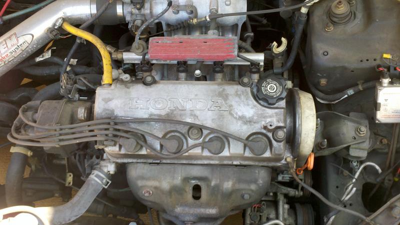

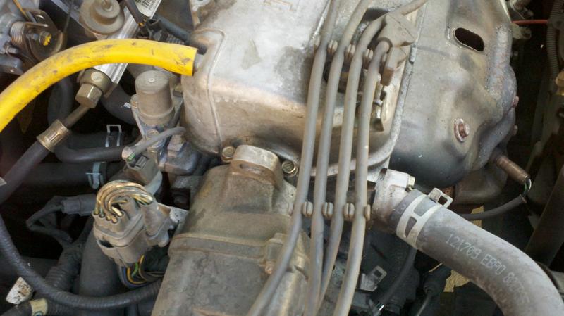

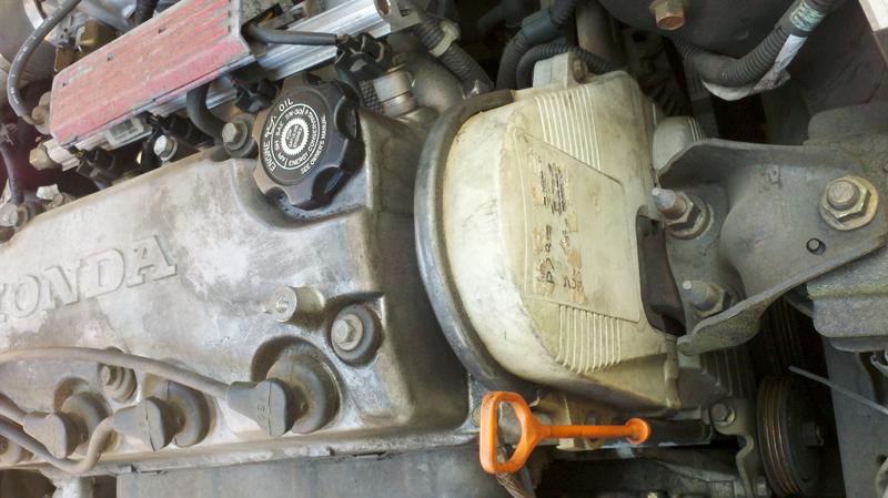

Hello fellow members I just bought a 97 hb civic with an engine swap. Can you help me identify the engine.

look below the upper radiator hose (probably about a foot below), where the engine meets the transmission. Should be an engine stamp. Should have something like "D1---" the dashes would, of course, be the rest of the engine code.

Looks like a D16Y7, but I could be totally wrong on that. It also looks like you're missing all of your power steering components, as well as your A/C belt

not a y7 as it has a VTEC solenoid, could be d16y8 but the injector plugs looks square so if the converted to obd1 it could be a d16z6 (92-95 Si) or a d16a Vtec(jdm) or it could very well be an obd1 d15b vtec
