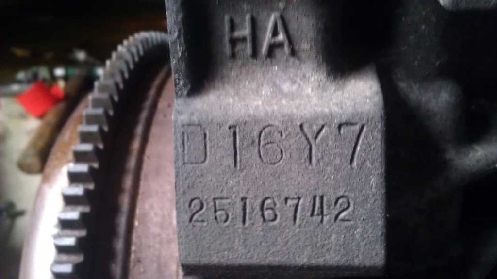

Well as far as the engine goes, that's right 2000 si has a D16y8 which is a single overhead cam, one of the few VTECs that are SOHC. I'm not sure why the door sticker says 185/65/R14 because the si should have been sold with mags that fit 195/55/R15. The 185's are for the steel rims that fit my car.
If you want to be sure which engine is in the car 'D16Y8' is stamped on the block below the distributor on the front of block next to the transmission.

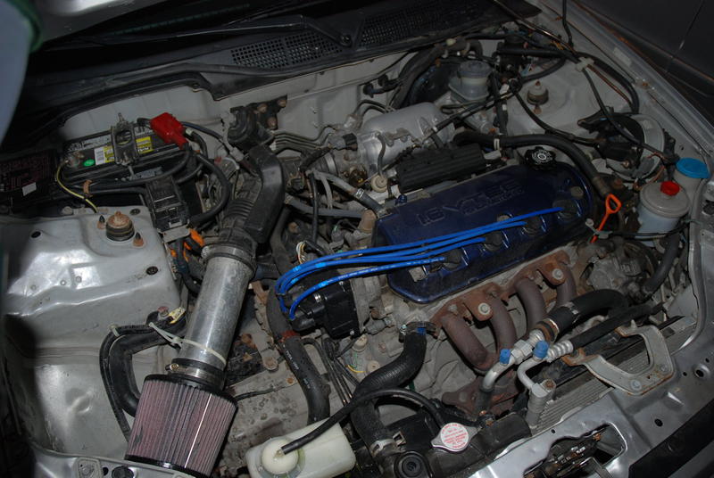

The mystery continues. I have a 1.6 liter VTEC valve cover, and all I can see in terms of an engine stamp are the letters HA. The tire stick shows 185/65/R14 and the car has steelies with plastic covers on them.
Pictures attached to my sons profile.
Thanks for your help.

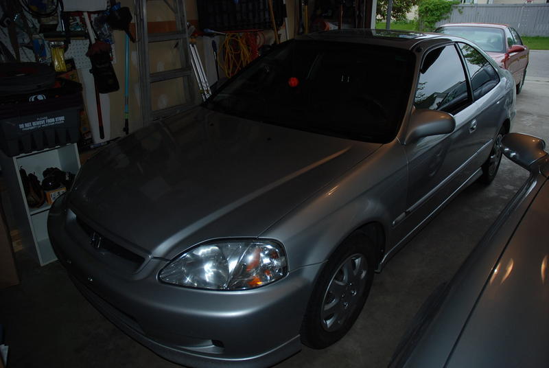

Here's a shot of the vehicle and motor attached
ID:	83500   Click image for larger version

Re: Si or Not?
I've reviewed many Google images and after doing so I am convinced I have an EX coupe not an Si, despite the branding and CarProof report which shows the car as a 2000 Civic Si, assembled in the USA. Now better call the parst guy and make sure that rad on order will fit the EX..........can any confirm the EX vs Si for me after looking at the pics I posted?

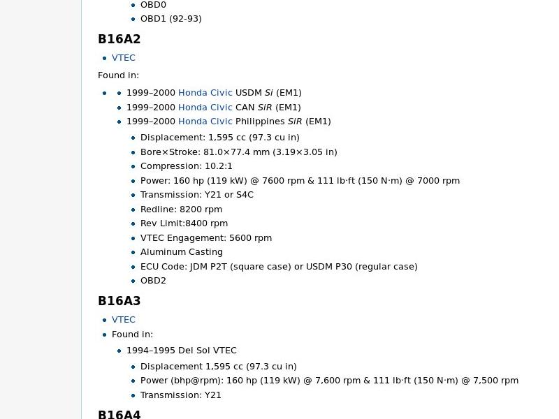

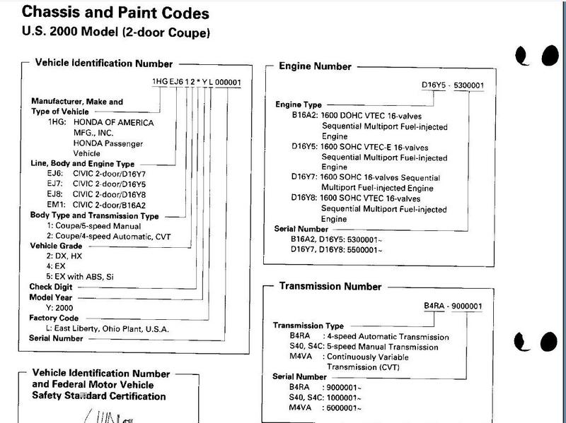

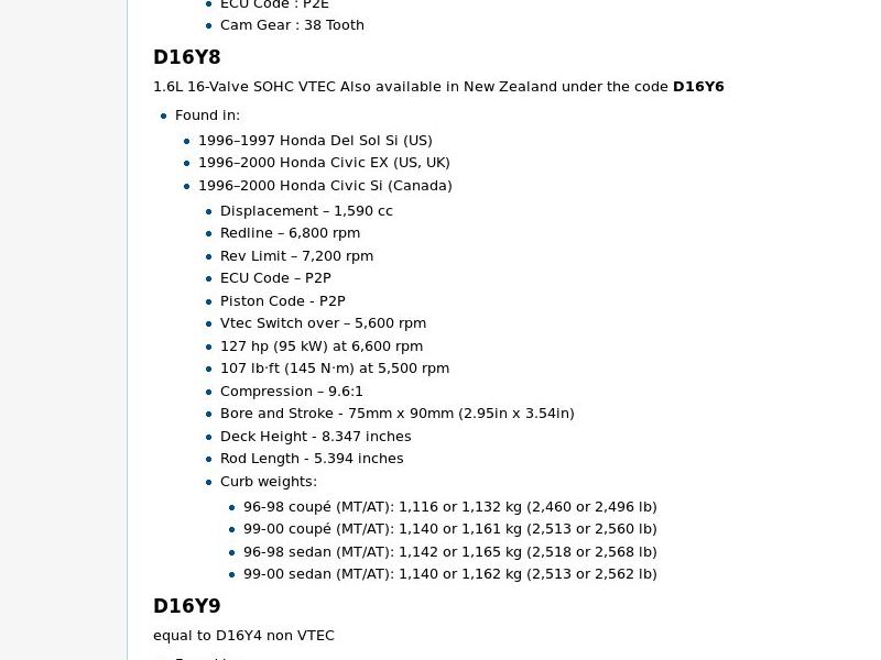

Confusing stuff... If it's a Canadian SI then D16Y8 (American EX). If it's an American SI then B16A2.
FYI - Canadian models are also assembled in the US. Mine was made in Ohio.
Name:	VIN identification.jpg
ID:	83502   Click image for larger version
ID:	83503   Click image for larger version

Thanks again. I checked my VIN and the first series is 1HGEJ8274YL, so other than the digit "7" - which doesn't seem to match up with any of the vehicle grades shown, it's a made in the USA Civic 2 door coupe witha D16Y8 engine.
Any idea where I can check and see what a vehicle grade 7 is?

Really just sounds like you have what Stock99 alluded to: you have a Canadian Si/US ex.. The d-series under the hood is a giveaway.
http://en.m.wikipedia.org/wiki/Honda_D_engine#section_5
Scroll down to "D16Y8" and you'll see US ex and Canadian Si under the list of cars that engine is found in.
Also, the USDM Si with the B16 never came with a manual tranny
