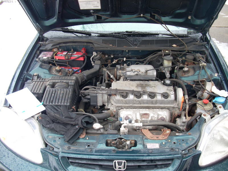

I've posted a few pictures just for the heck of it as well.

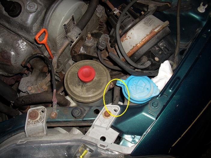

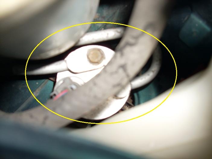

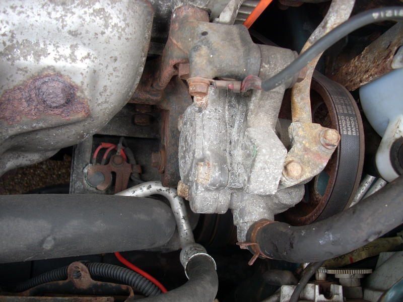

Edit* I am curious what part is below the power steering & wiper fluid? It looks like it may be new.
Re: Beginner trying to learn some basics!
It's kind of below the washer fluid tank. There is a tube blocking it, but you can see it mostly. Sorry, it's not a great picture. I gather it's probably something like a pump of some sort? It just looks in better shape than most things in the engine compartment.
Probably insignificant to be posting about I guess. I'm new
That's the receiver-drier for the AC system. It's aluminum and usually somewhat shiny unless it's covered in dirt.
If that was actually a new part then I'd expect something else major was replaced at the same time, like the compressor.

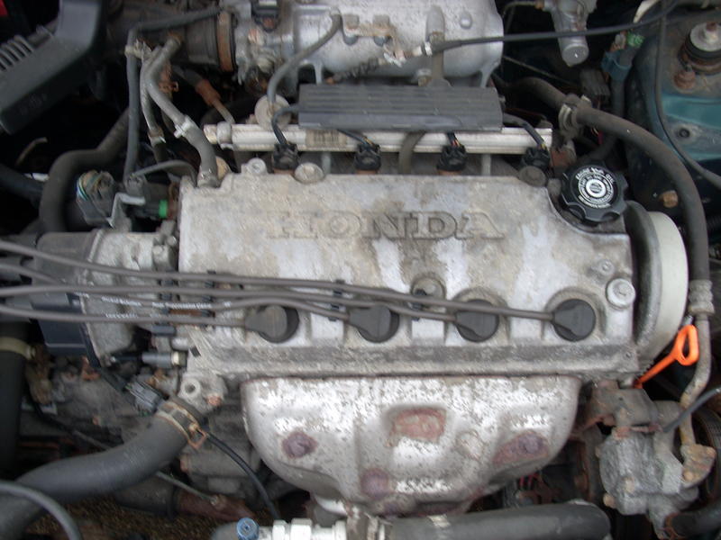

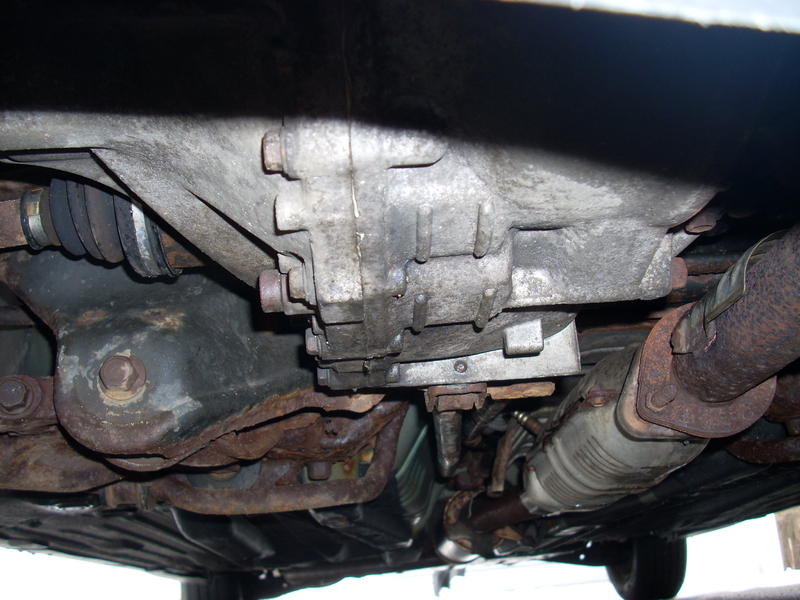

I've spent some time over the past few day's taking time to check the oil and coolant before start-ups after letting it sit for the night. I've gotten a good indication of how the car is using some of it's life sources.
The sludge in the reservoir isn't very much at all & it's medium dark in color maybe more of a dark gray than black...and as I mentioned it isn't very much and that hasn't changed over the day's that I have noticed. So I think I was just being over paranoid about that. But I will still keep an eye on it for some time (as everything) because I'd rather be safe than sorry.
The strange thing I think I've noticed about the oil (and maybe it's all cars) or perhaps not? Is that the oil readout tends to vary for this car even if it's sitting on the slightest of angles. I had been parking in a different spot and checking the oil and it was about 25% lower on the stick than previously, which I thought was odd & I thought all of a sudden I was losing or burning it somewhere. After parking the car where I had previously after purchase and checking it again the next day it was reading to the line on the stick and it looked decent.
So, I am becoming more confident that the motor and cooling system are sound....but as I mentioned I will continue to monitor until I feel comfortable not doing so. Still need to get on some ramps and check the trans fluid. I will try and get that out of the way soon.
I believe I've learned that I really got screwed so bad on the last car I had I find it's given me some ocd in regards to checking these fluid levels and might even do it everyday to please my paranoia.
However, previous paranoid issues aside I have found a legitimate problem with this vehicle. I'm getting some electronic issues
(dash lights going out, radio issues) I don't yet know the extent of the problem.From what I gather they can become a very large headache, so I will take some time and research in the electronic section of the forums here. I'm just going to keep my fingers crossed and try to get some other things done and taken care of before I attempt to even sort that crap out. They would come on after a small amount of force implied from my balled up hand on top of the dash and quickly go back out. So after some slight knocking on surface (not to inflict damage, I was careful) they eventually stayed back on.
Looking into the past, some of the things the seller mentioned make more sense now with this issue.
