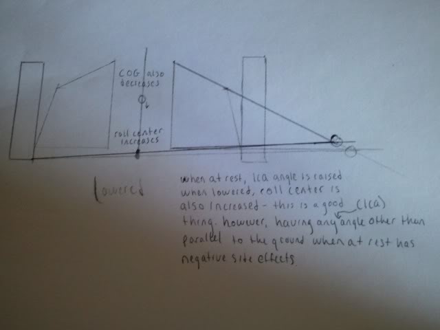

Here is the suspension geometry of a double wishbone suspension setup, at rest, when lowered without the extended ball joints. Notice how at rest the LCA's are at an angle. This is bad. Notice how the RC (roll center) is increased. By moving the roll center closer to the center of gravity (COG), the car will have less roll under cornering. This is good (with a caveat, see below).

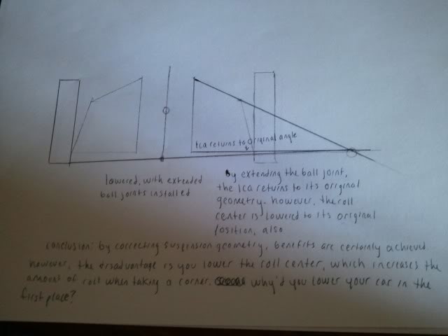

Here is the suspension geometry of a double wishbone suspension setup, at rest, lowered, with the extended ball joints. Yes, the LCA's are now once again parallel to the ground, thus restoring the original geometry of the vehicle. Fantastic. However, the roll center was also moved to it's original position. By doing so, you've increased the amount of roll that the car will have under cornering. In a way, having increased roll under cornering is a good thing on double wishbone suspension, because the more you roll, the more it compresses and gains negative camber, thus retaining more grip (thanks Sdaidoji )
My conclusion is: yes, even though the roll center is put back to its stock setting, this issue is almost entirely negated through installing stiffer springs, roll bars, etc. By having increased camber adjustability, and by correcting the suspension geometry of the vehicle, the pros far outweigh the cons. Though it's expensive, given the extensive quality of the product, I can't see you ever having to replace a ball joint again. And on a track car, that's peace of mind.
I have heard unconfirmed rumors that the wilwood BBK for EK's will cause these to rub against the rotor.
I am sure some of the suspension gurus on this forum will have their own opinion on this and I very much welcome it. Most of you guys have a lot more experience and knowledge about this stuff, so if I have this totally wrong please correct me.

i would say that having inceased roll for a doublewishbone is not bad, rather desired per se. PS: your rear is not double wishbone :P
the more it roll, the more it compresses and gains neg camber, so will reatin more grip. Not desirable in 7th gen and above, since struts will not increase neg camber gains when compressed, opposed to double wishbone in 6th gen

Originally Posted by sdaidoji
i would say that having inceased roll for a doublewishbone is not bad, rather desired per se. the more it roll, the more it compresses and gains neg camber, so will reatin more grip.
this is why you're awesome, haha
