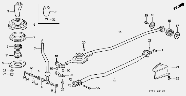

I had the loose shifter problem for awhile and finally got around to fixing it. It's very easy to replace and will cost about 70$ in parts. Luckily I took some photos when I was tearing it apart.
You need part numbers 24, 4, 5, 12, 26, 19, 10. Essentially you have part number 12 which is the core. Part number 24 are the rubber o-rings that go around 12. Take a TOOON of grease and squeeze part number 5 on either side of part number 12 (with the four new o-rings on it's going to be a very tight fit which is what you want). Finally you have part number 4 which is a large rubber bushing that go on the outsides. Swap that back in and voila--your shifter is as tight as it's going to get.

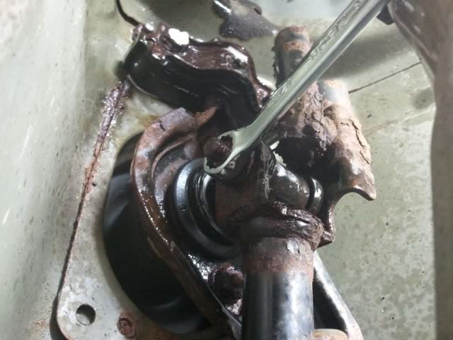

For visual reference:
Yes that's a 12mm wrench. It's going to suck getting off so spray the crap out of it with PB blaster. That's where you're going to be squeezing in your new parts (12, 24, 5 and 4). You can see that they're in pretty rough shape. I bought a new bolt to put on there but it's already starting to rust *shrug* oh well.
The next step is to replace the two other bushings on the shifter linkage--Part number 15 and 18. Energy suspension makes a polyurethane bushing that you can swap in that make's shifting much more crisp--doesn't really help with the wobble though. This is where part numbers 19, 10 and 26 come into play. These parts will be nothing short of busted when you pull them off so it's good to replace them with fresh ones. Up front you just pull the bolt off, pull the bushing out put the new bushing in. Just make sure you really grease em up otherwise they're going to squeak like no tomorrow.
