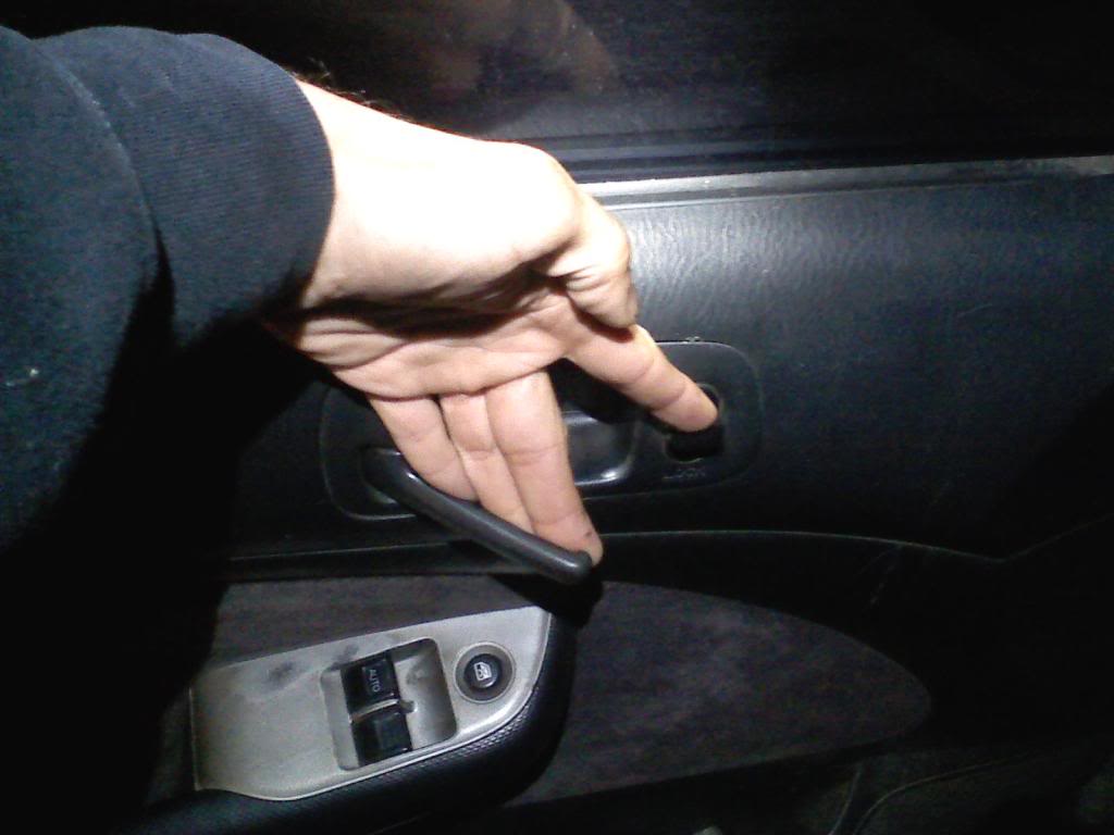

Re: Just bought a 98 Fixer Upper...newbie here needing help!
They're all like that so you don't lock your keys in the car. Pull the inside handle and lock it manually at the same time.
Like so:
I've been doing it for so long it's one fluid motion and I don't even notice. lol
